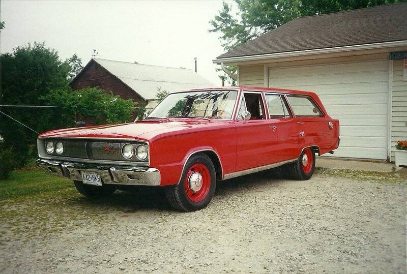

I changed my 1-of-0 1967 Coronet R/T wagon from automatic to 4-speed in the mid-'90's. I found a 4-speed hump and pedals in a junkyard Roadrunner. I got a 4-speed trans complete with non-console Inland shifter at Mopar Nats. I think all the Z-bar bits and pieces came from Year One. It was neat to have a 4-speed wagon at car shows. Since 4-speed cars just sound different than automatics, I usually had a small bunch of interested folks gathered by the time I got backed into a show spot. I made the mistake of taking the wagon across the border to Port Huron, MI annual summer cruise night; something like a mini Woodward Ave. cruise. After an evening of stop and go cruising, my clutch leg was throbbing. One other time, I swapped the 3.55's for 2.94's, added a cruise control setup from a Cordoba, and our family took it on a vacation to visit family in Tifton, Georgia.
