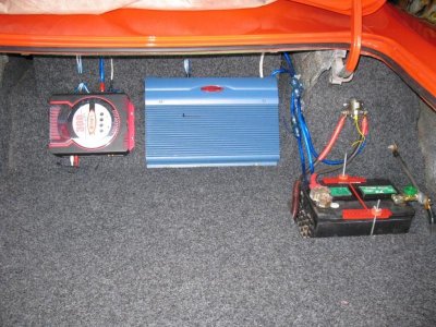

I ran my 0/1 gauge wire through the frame rail, crossed over and right to the starter. But I used a solinoid in the trunk instead of going to the engine bay, less wires.
AL
