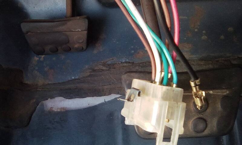

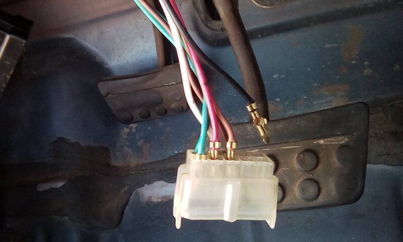

When I push one of the wires into the plastic connector, it seems to stick and I don't really want to take the chance and force it in because I might break the brass end of the wire.
I had to force those that I got into the plastic connector, but would rather not take the chance.
So if you know a better way, let me know.
As long as you are certain it's going back in the same way it originally was, use a something like a scratch awl or screw driver that will fit down into the brass socket and push there, not on the wire crimped section. A bit of wiggle and it should pop back into place fairly easily.
View attachment 1075512 View attachment 1075513
You didn't bend the tabs to far out did you? They won't want to go back in if you did.
take a very fine straight screwdriver pull the small clip up when you push them back in you should hear a small click. i did mine that way.
First I want to Thank everyone who responded to my post.
Secondly, I found that there is in the plastic connector a small raised rail that fits the bottom of the pin and that mine were closed. Which of course made it difficult to push into the plastic connector.
I took a small bladed knife and ran it along the channel in the pin and pushed the pin into the connector.
So if you are going to replace the turn signal switch on your car, check the bottom of the pin to see if it is closed.
I hope that that will help someone else in the future.
