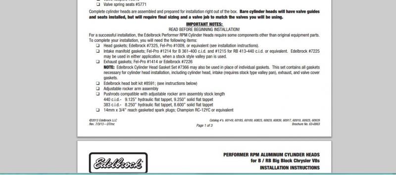

Here's a clip out of the performer heads instructions, if that helps out:

Thanks for all your replies. I noticed that Edelbrock recommends the 1009 as a choice for head gasket in their instructions for the head installation. I have decided to do a clean up surfacing on the heads, and use the .020" steel shim gasket with copper coat spray. Then I can maintain the .037" quench distance on the 451. Have seen multiple users with this combination with no problems reported other than some brinneling of the head surface. Will let you know this summer how it works out.
