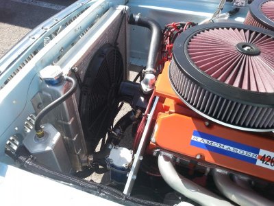

split hdrs.jpgI use ProForm Locking Header Bolts and they work great.
Note: This posted picture is NOT of my motor but of a fellow Mopar Racer that has cut his header flanges like I have described below.
THE MAIN THING IS:
The main reason headers leak exhaust gases at the block is that the Header Flanges are NOT seating flush against the block.
Brand new headers should not be a problem but older headers may have "warped" over time and are not seating flush against the heads.
The way to overcome headers that have warped flanges and will not seat is to remove the headers and "cut" the header flanges between the front pipe and the center two pipes and then cut the flange between the rear pipe and the center two flanges. This allows the header flanges to relax and to tighten down against the block.
If you think about it you have probably seen Mopars at the track that have had the header flanges cut like this.
The reason the manufacturer has the flanges go all the way across is to put the header tubes on a jig and weld them up to a solid flange to make sure all the header tubes go where they need to go.
Side Note: I have just seen the "RemFlex" header gaskets on the Mancini site that state they will seal about anything. I think these will be ny next header gasket purchase.
