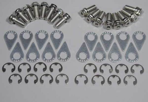

Even lock washers fail where heat is present. Possibly star washers could work as they bite into the mettal on both sides? Studs with their fine threads seem to work a bit better than bolts but still need re torqed now and then.
Never had any of these back out...
How hot do the bolts get anyway, being in the water jacket? This is good for 450 degrees. But removing them later could be an issue.
I have the same bolts/locks as post #6 with Remflex gaskets, never a leak.
