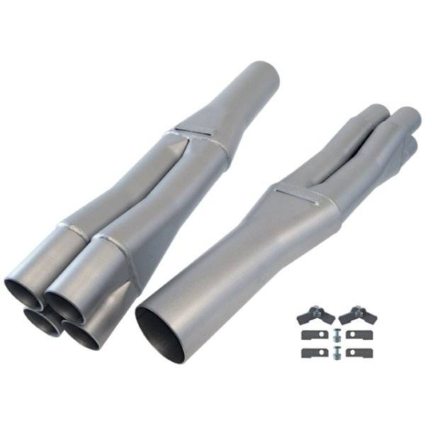

sort of like this style collector

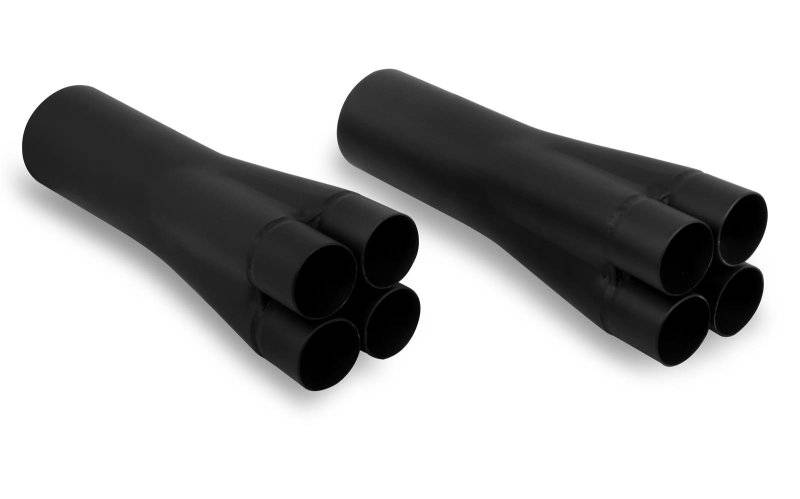

more custom deal/aftermarket collectors
