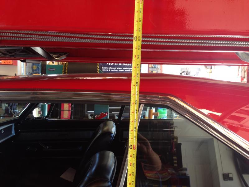

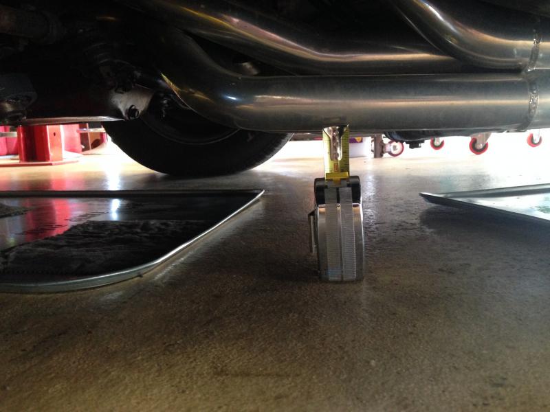

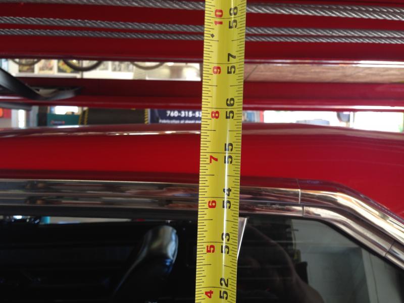

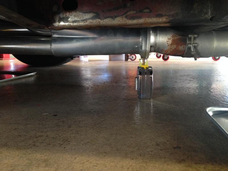

Here is a couple of shots from mine. 2" units on a 440 in a 65 Coronet. My car might be lower than yours, 56", which will effect the ground clearance. When I do kang a speed bump or drive way ramp, it usually tags just behind the collectors. BTW, the clearance is 5" front and 4 back IMG_0925.jpgIMG_0926.jpgIMG_0927.jpgIMG_0928.jpg
