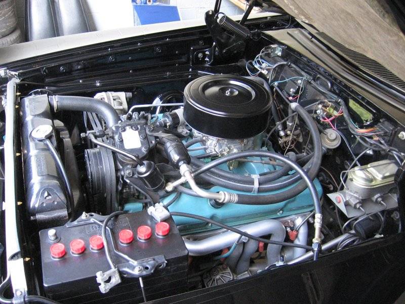

I used TTI on my '62 Sport Fury. 440 t-Flite. The car had power steering, power brakes and AC. I've installed dozens of headers in different cars over my many years, These were this first ones I didn't have to dent.
^^^^^^ Agree Call TTI and ask for Mike Rabby. Tell him what you have. I have used many TTI headers and systems over the years and only had one problem.
ME ! I asked for Hemi headers and gave them the wrong K frame that I used.Though my mistake they went out of their way and replaced my driver side header with the correct one for the K frame that I used.
This photo is a 64 Fury with TTI's .Always use New engine mounts along with new transmission mount and you won't have to ding anything.
