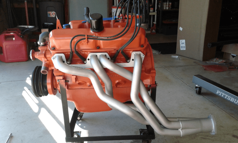

After some research (and eliminating TTI just because of the price), I went with Dougs. The fit was pretty much dead on. I have a starter for an 89 Dakota pickup because it's a bit smaller, a Napa Gold oil filter, and 1.03" torsion bars, and the headers slid right into place. I did have to crease the pipe under the oil filter juuuust slightly. They were a good price through Summit Racing, a great fit, and I would buy them again in a heartbeat.
It's a 340, but as you know, the block is the same.
Sorry Adam. Forgot to mention... this went into a 68 Coronet also.
