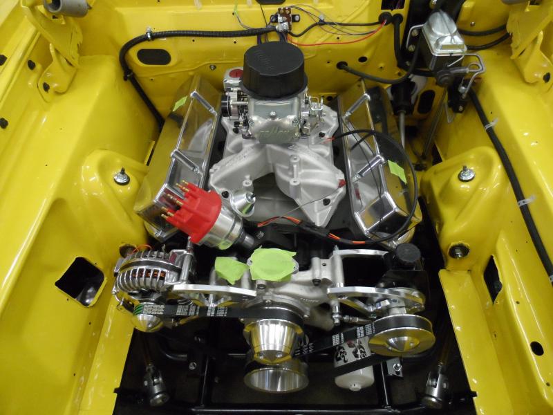

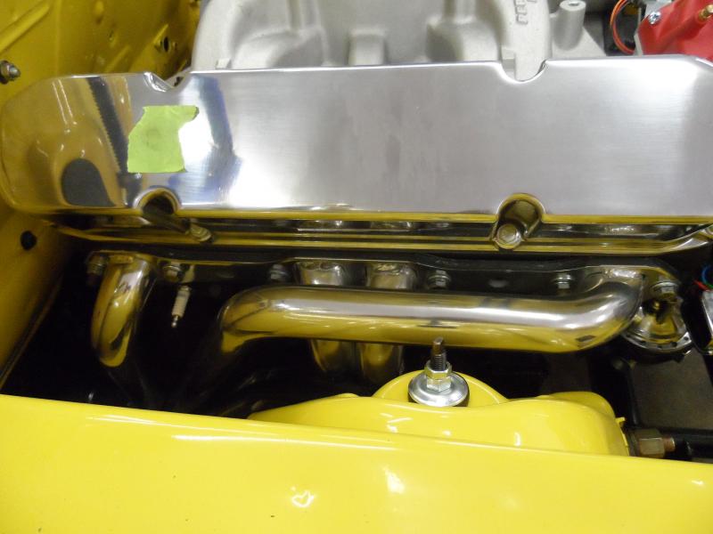

I put a set of Dougs 451 on my 65. fell right in low deck engine. SAM_0546.jpgSAM_0550.jpg
