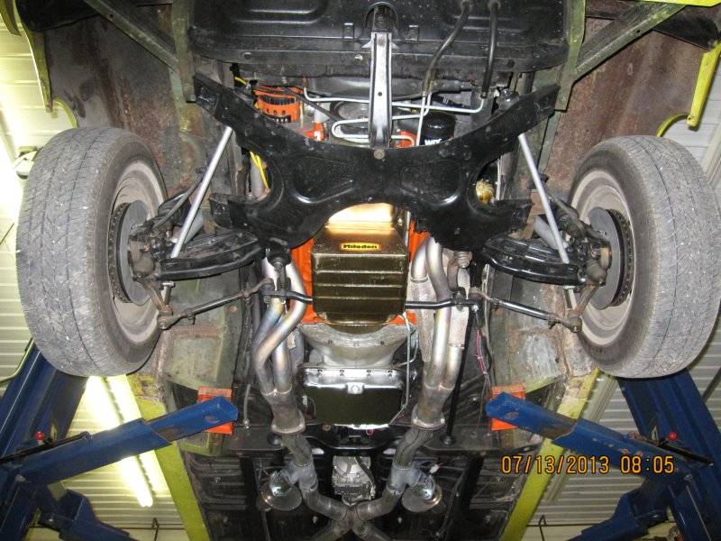

The Dougs headers I bought for my 66 Belvedere fit like a glove.

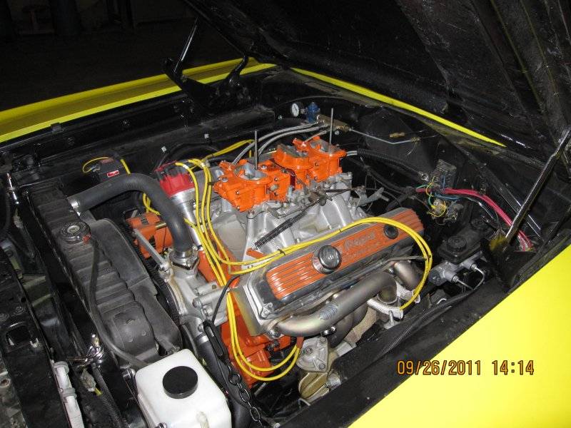

I agree. I would believe they almost have to fit if you can get headers in there. 73/74 cars didn’t have as much clearance as your 67 so I would say if they worked on 73/74 they will work on a 67. That’s coming from a guy with a 74 b-body 440 with hooker headers.
They will work without issue. If you order the rest of your exhaust system, be sure and specify the year of your manifolds. Some angles are different.
Manifolds are fool proof and low maintenance, and the 73's will fit.
TTI headers fit nice. Haven't used Dougs, but hear good things about them.
I would avoid the Hooker 2" primary headers, but the 1-7/8" are OK.
