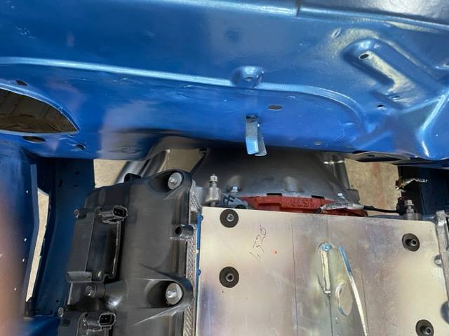

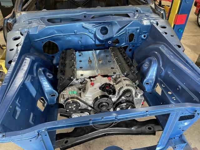

Doing a swap on a 69 RR was going to use the hooker bkackheart headers and their mounts but I'm not if they even make them anymore. Looked on Holleys site and it shows unavailable. What's my options with headers only tti. I know they won't work with the holley engine mounts thas what tti says. The holley mounts move engine forward so the intake clears clears at back of engine right. So if the tti mounts don't move forward what are my options. I've done a swap before in a e body and the holley kit worked ok. Does anyone know if the US Car Tool engine mounts will work with tti headers.

Curious what you ended up doing for headers and connection to exhaust for your swap. I also used Holley motor mounts and using 8HP70 trans.
Any advice would be appreciated.
