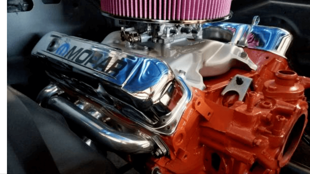

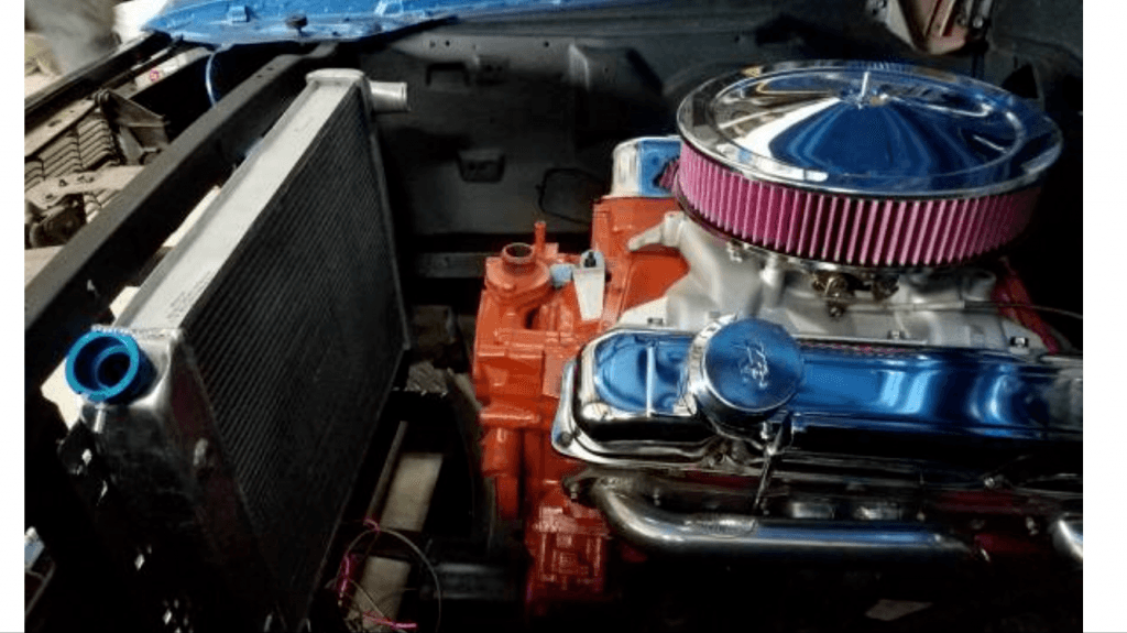

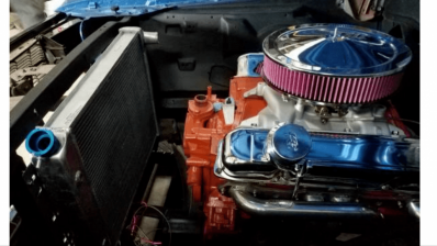

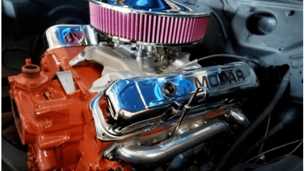

I use dougs
I use headman all the time on my 71-74 chargers the shortys are good long tube I prefer better they all will fit fine with power steering make sure it's for a power steering setup big block good luck
