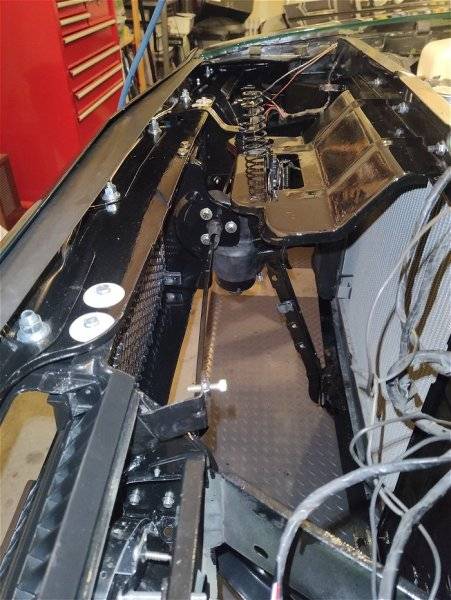

Is it the same as on a '70? On my Charger, the headlight doors have an adjuster screw that limits the rotation, and the screw end butts up against a rubber stopper when closed, like pnora said.
The adjuster screw is the silver one in the foreground, I had to install longer ones because the original screws let the doors go down too much and lined up below the grille.

70 is totally different than 68 and 69.
Thanks, good to know. I knew the move from vacuum-operated to electric motor was a major change, but didn't think the mechanical operation of the headlight door rotation would be that different.
