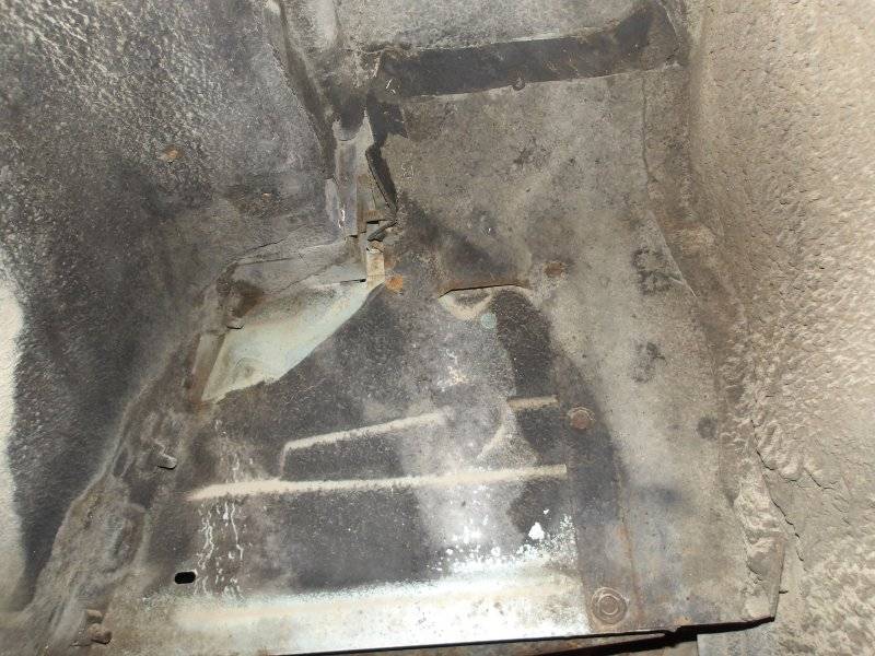

Here is a picture of one I'm pretty sure has never been apart. Passenger side, drivers side is too crowded with stuff to get to.
If a better picture is needed? I can provide.
Thanks made more sense once I was able to get the car in the air see how it laid out f for some reason I was thinking they went between the rad and core support . Thanks again
