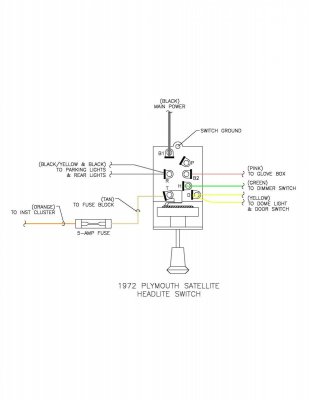

I don't know if this helps or not considering I don't know what you have.... but I had drawn this up on autocad for a previous post I had a question with. The letters are not the same as yours but I would think that maybe with the color and wire indications shown you might be able to put two and two together. One correction though, and what I had previously had not known.... the pink wire shown on my diagram is actually coming from the fuse box where it's (red) at that point. It goes to the glove box and cigarette lighter SUPPLYING power to the headlight switch where it's (pink). The main black one is supplying power to the switch as well. Hope this helps.

it is a rocker style rallye dash switch
the switch in question by part number is a wiper switch no a headlight... ebay rip off I guess... person I bough it from put it in the headlight location on the dash is what it looks like. Bought switch from ebay.. non rallye dash but it will still work, I need a car to drive.... this is just a quick fix until I can do the proper restoration..
working on the tail lights now.. I put a whole new harness from painless in, so there is no guessing or messing around with the old wiring.. there is so much corrosion and dirt it didnt look to worth trying to salvage and I didnt see the value to it anyway. I'd much rather know my wiring is new and not worry abot cracking and dried out insulation and a fire started from a short. I ahd that happen in a 71 Challenger I had ..wasnt fun driving down the street at night and your dash literaly chatches fire... and the headlights go out..
