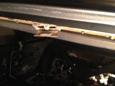

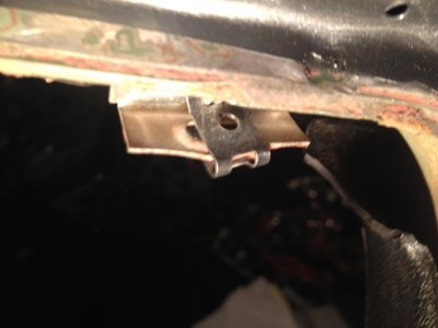

Can someone assist me in how these work (68 RR)? Is this what the headliner trim panel screws into or does the actual headliner fit into these somehow? Only one has a threaded clip attached to it but not sure it belongs (see first pic)? I tried to figure it out from my service manual but the pictures in there do not help much.
Thanks!
Brian
Those clips go on after the headliner is installed and only serve to attach the top inner window molding to.
That threaded clip does not belong on there that clip has the screw hole stretched that is why someone put a threaded clip on it
