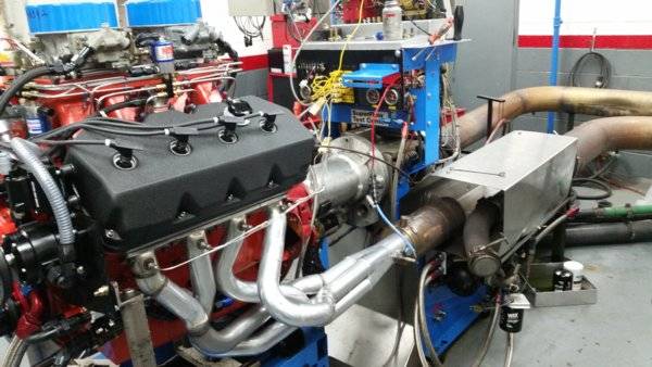

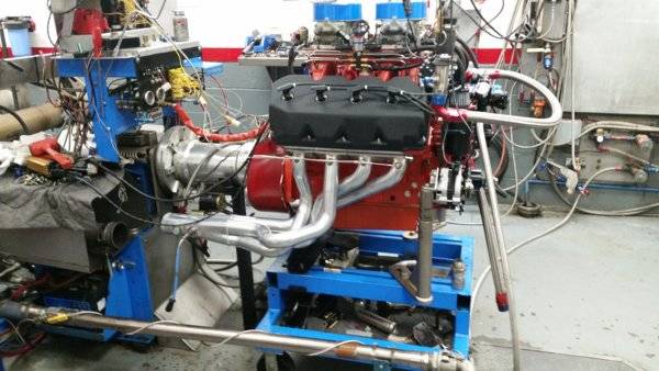

Currently, I did have to cut up & modify the #1 header tube on my Hemi Headers for my 70' Challenger on a different set due to the RMS K frame & rack though. it was not a big deal all of the other tubes fit fine. We even used them as my Dyno headers. I didn't care about the ceramic coating which did not even blister or peel after 19 hits on the Dyno. They are painted satin black now anyway in the car for that more correct "OEM look" anyway. LOL.
Next set for this car will be some big tube custom made headers but from now on any other street or strip car I will be using TTI after all the postiive feedback I always read.
