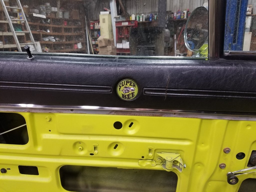

The front upper panel are from a Charger, but I like them. I can fit a refrigerator magnet in the spot where the medallion went. Silly as it sounds, I may repaint the magnet to better match the interior and leave it.

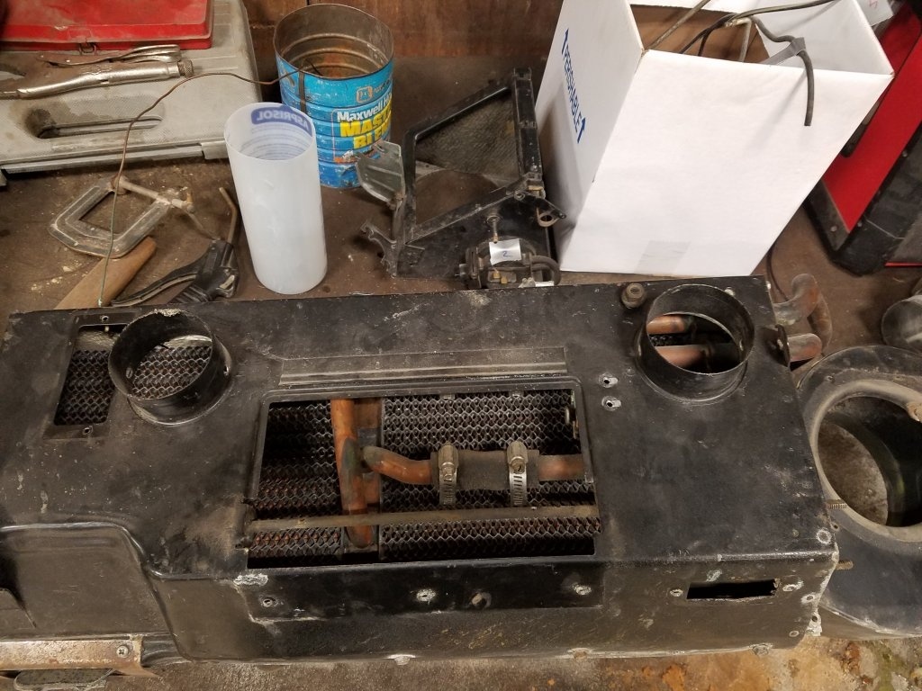

Now is the time to remove/clean/rebuild/pressure test the heater box and core, remove/clean/replace the under dash insulation, and remove/replace the wiper pivot seals. Detroit Muscle Technologies sells everything you need in the way of gaskets:
http://www.detroitmuscletechnologies.com/
For the heater bypass valve rebuilt kit I'd try NAPA. Classic auto air will sell you a heater control valve if yours is stuck (likely).
Bought the big Heater box over haul kit, firewall gasket kit, splash shields kit, and a few other items. About $375. Hopefully the core and evaporator are fine and only cost money to clean and pressure test.
Keeping this portion of the resto under $600. (Add that to the $1500 that the Vintage Air kit will cost, and the wire harness and other items needed.) And keeping this car A/C had better be worth it. Lol
Its your car, that is the beauty of it, you can put refrigerator magnets where ever you want lol.. I would sell them pads and paint the door tops, and get steel panels for the back lol...
But in case you don't want to use the magnets, you can get decals made the correct size with whats called a jewel finish, or you can make them yourself just measure the sticker you want to use and buy the correct size jewel domes https://www.amazon.com/50-Pcs-1-25-...1486867791&sr=8-2&keywords=sticker+dome+1.25"
It really is that easy lol, I have a guy that will print you what ever color super bee you want what ever size you want, and then just put the domes on it, and you are done...

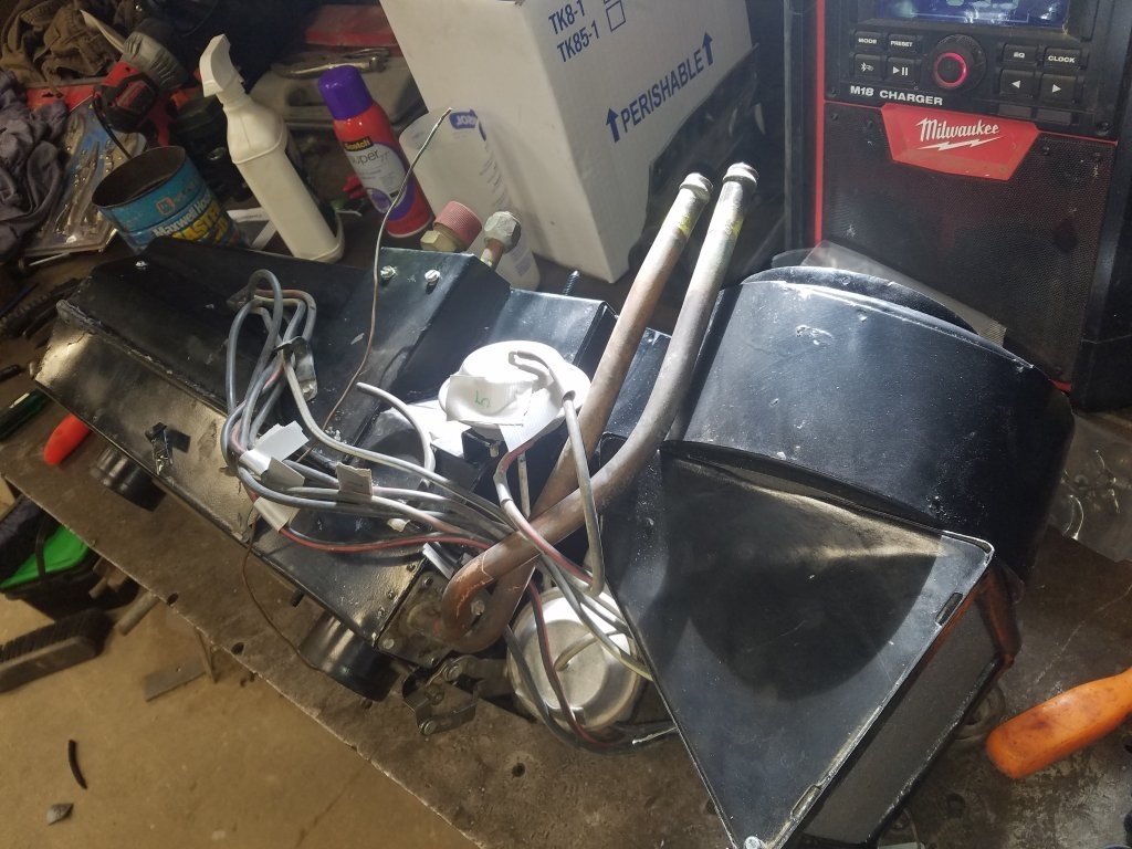

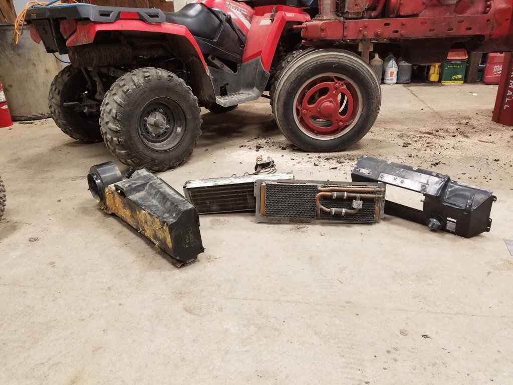

I got it partially disassembled today. Getting the blower off was tedious. I think my vacumn actuators are still good.

There weren't rodents in the heater box, but there was a fair amount of fine silica sand from the blasting
When I was younger we used to dry ear corn in a crib. Every July we would shell corn. Long story short. Use duck tape to tightly secure your pants legs to your ankles. Lest you invite unwanted rodents to scurry up your pants leg. I once saw a rat run up a guys pant leg. He reacted quickly and caught it before it got to his balls
That sucks, you need to get that all out of the car... When I used to have cars blasted a while back, I invented little blowout tools for spots that I couldn't get to ..

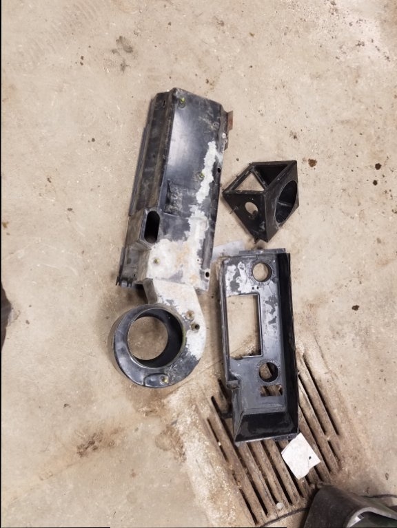

Got it disassembled and the insulation and gaskets scraped off housing. Tomorrow I will call the Radiator Repair guy (45 miles away) and see if I can drop the core and evaporator off.
Got all the advehisive, insulation and gaskets removed from interior of heater box housing pieces.
Tomorrow scuff and prep outside of heater box housing components for primer then flat black paint and clear coat.
Hopefully the heater box overhaul kit arrives and I have heater core and evaporator back from radiator shop by friday

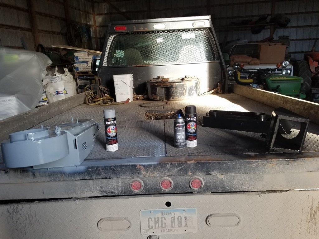

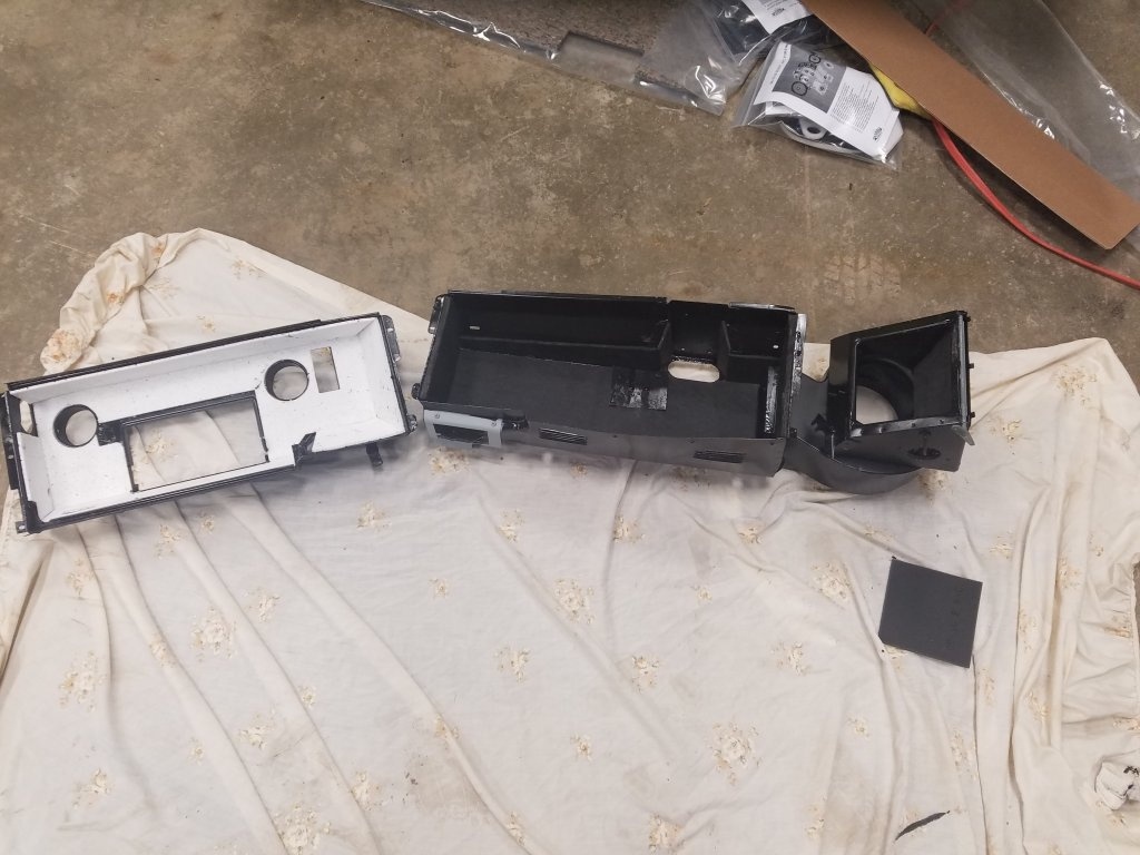

Primmed and painted the Heat box housing components. Then applied a clear coat.
Used Seymour MRO grey primer and Seymour MRO Flat black rattle can. Those are my go to spray paints for farm applications. They cover well and are durable.

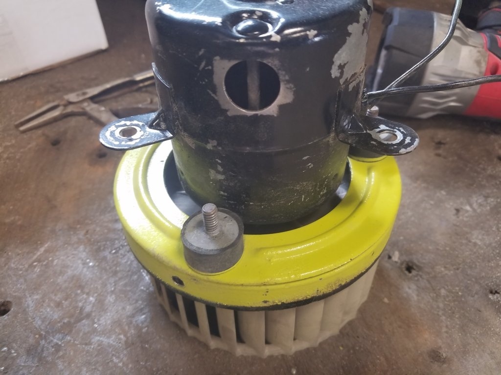

What do I do with the motor? It turns good. If it works when I put 12 volts to it, all she good correct?

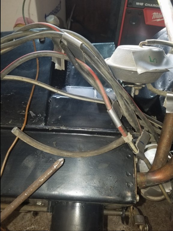

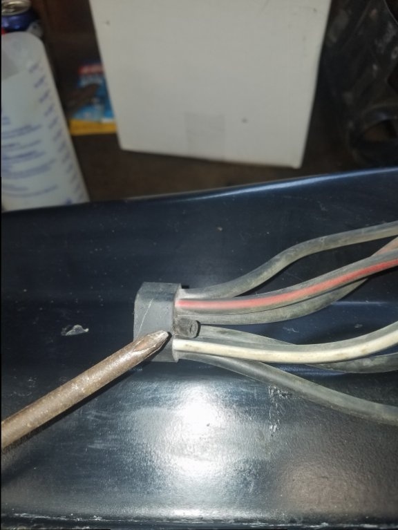

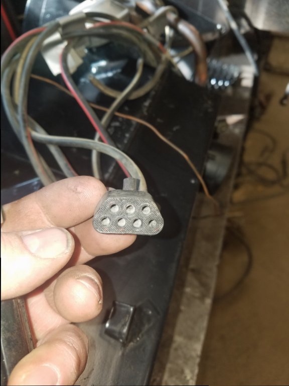

I have a coup less of uncertainties.
First. There is a T in the vacumn line that connects to the back of the actuator that opened and closes the large door on the triangular part of box directly in front of blower. It appears to be a harder thicker type of rubber. Not sure if it goes through the firewall to vacumn canister. Or if it is designed to go to nothing
Secondly, there is a small partial hose coming from the plug. I originally thought this hose went through firewall to vacumn canister. Not so sure now. It doesn't appear to be same type of hose as the one in question above. So I doubt that this went to that.
