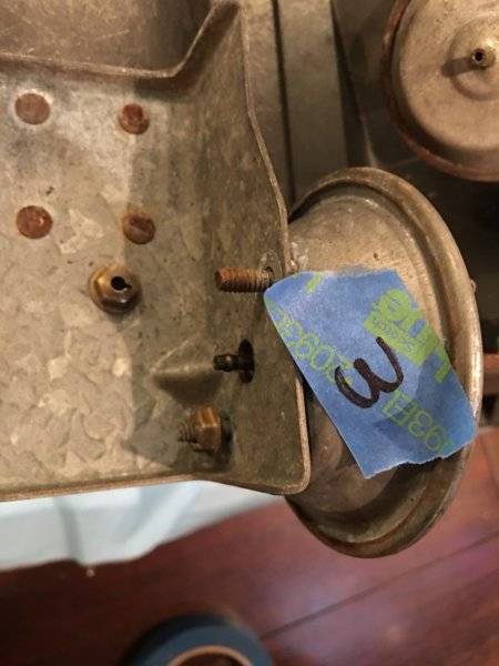

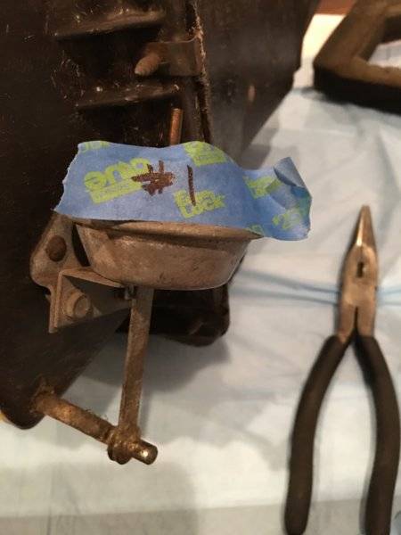

Ok, tons of pictures and easy to take apart, and now on to removing rust, cleaning and painting, and getting the evap core tested. Most of these, although dirty and the metal is corroded, they plunge and push air. One, I can tell has a leak in a diagram. Where do I get a new one, or get them all checked out, cleaned and restored?

F9B0FB92-973D-4F17-A915-C546EA540820.jpeg C73179FC-EDC5-42E5-8CD6-44A248CE8E45.jpeg 2DEC2383-003E-42F1-A3E2-2904E10F7523.jpeg

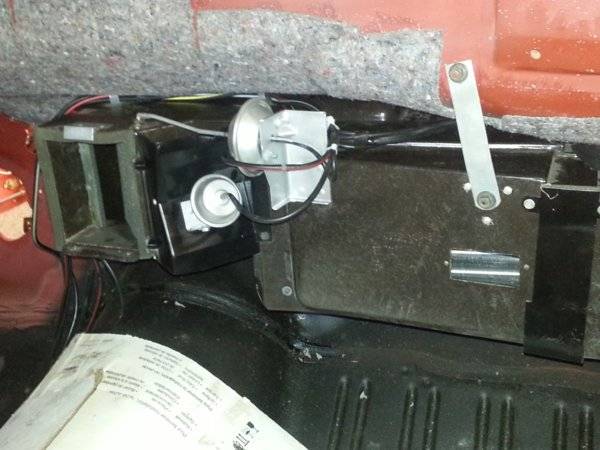

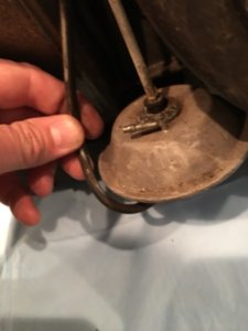

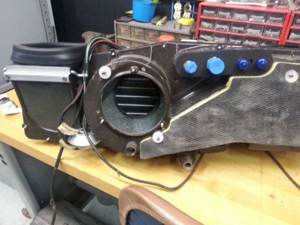

The '71 box is not too hard to rebuild, and add new seals and such, but i have no idea how to rebuild the vacuum pods? My vacuum pods (or what ever thay are called) were in good shape in my car. My biggest problem was rebuilding the vacuum control switch. Somehow the plastic plug end had been cracked and broken. I could not find a B-Body control, but found a vacuum control that was almost the same in another car. I think an A-Body, but they have a different rubber vacuum circuit block inside, so I had to split both controls and glue the connector part onto the original control.
I did my own and as stated take LOT and LOTs of photos. When you think you have enough take 12 more, trust me. I bead blasted all the parts and repainted. Bob at GlenRay Radiator will re-core your heater core for $250. I would just do that for piece of mind as doing this job twice would SUCK. Like other stated the after market core are not the way to go. If you send it out you will likely get an aftermarket core.
Those vacuum pods aren't repopped from anywhere. How do you really know if one is bad? Just asking. I used a vacuum gauge on all of mine just to see if it held and worked under a vacuum. Then I bead blasted all of them, painted, and re-installed with gaskets from DMT. Yes, a non-A/C box is easier but can be accomplished with time and effort.

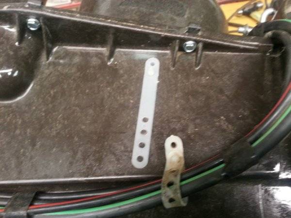

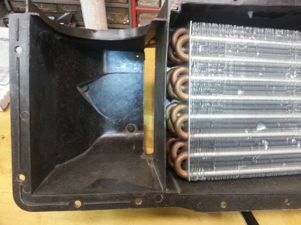

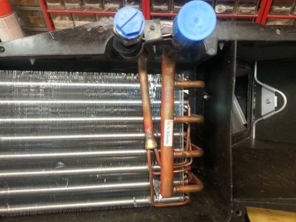

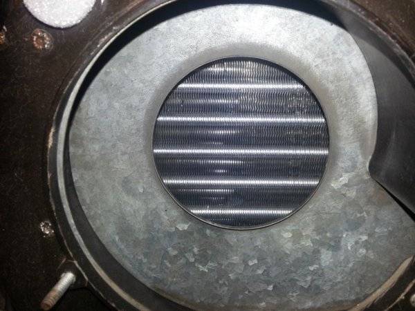

HB intalled.jpg thumbnail_20150117_150430.jpg thumbnail_20150117_150437.jpg thumbnail_20150117_150448.jpg thumbnail_20150117_162516.jpg thumbnail_20150117_170821.jpg thumbnail_20150117_170833.jpg thumbnail_20150117_170854.jpg thumbnail_20150117_170905.jpg
That is exactly how you test them!

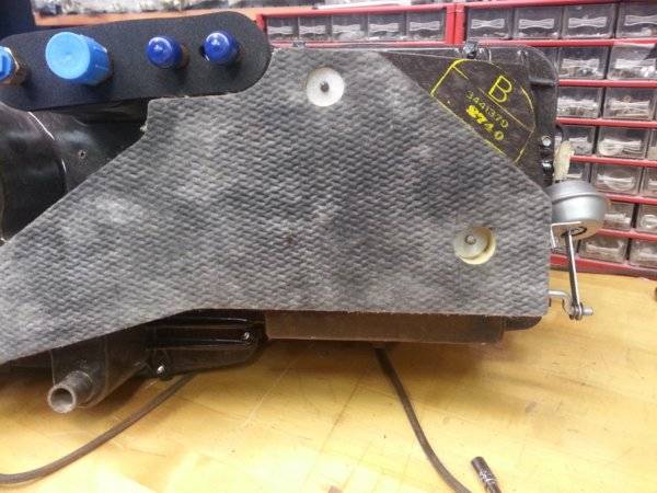

Forgot to mention that after I cleaned the case, I simply used a clear coat to protect it all and the markings on the case from factory

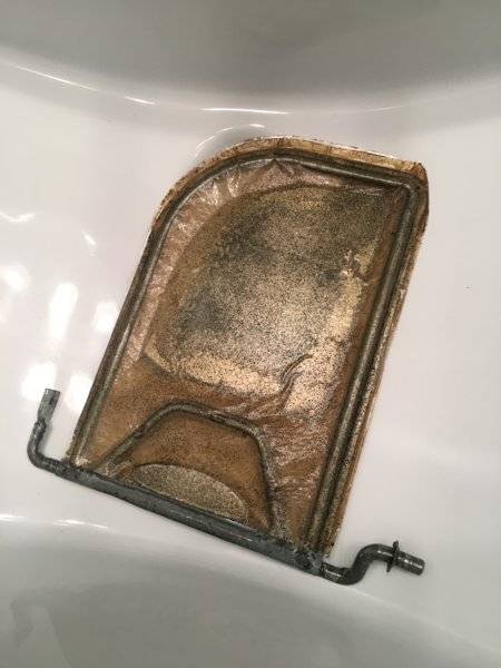

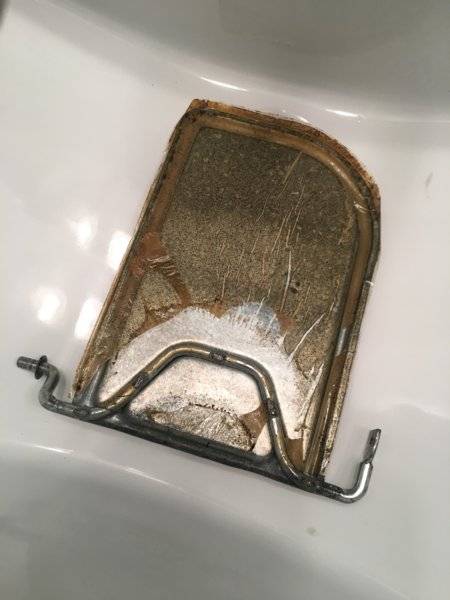

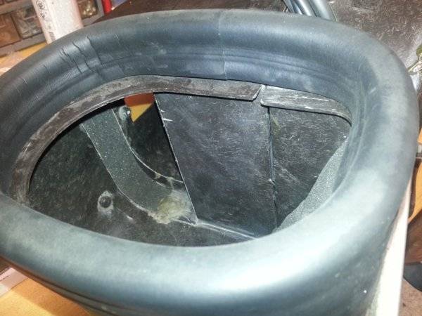

Ok, thanks for all the help everyone and here’s another question while I find an auto AC guy in the LA area! What is the best way to remove the old cellophane sheets???? Harder to remove than rust! Heat gun?
AFF747BC-7428-4662-9725-953A3E65B621.jpeg A1B29412-C0F7-47DC-A1C9-C5AB36758183.jpeg
Heat it and scrape it off. Or go to Home Depot or Lowes and go to the paint area and get some MEK (Methyl ethyl keto). If you get some, be careful. It stinks, have good ventilation
