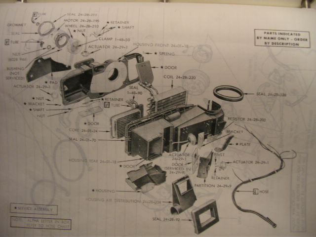

Heres you a Pic...:yes:

I think the motor plugs in to the resistor board, and so does the switch. Those coils on that board get really, REALLY hot, and a lot of the time they break.When that happens, the blower will do odd things. Maybe one speed. Maybe two. May blow high on low, low on the middle speed, and high again.
