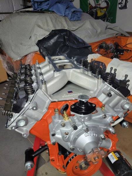

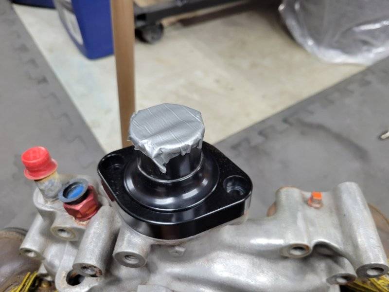

My housing is the factory original and the spring clamps are not holding. The housing neck is worn and pitted and needs to be replaced. I figured since it will be off so I would check to see what others are using.

Robert Shaw, the 370 type, probably 180°. I just bought one, cost was $50. to the door. As for your thermostat housing, i use the the o-ringed type from Flashpower #181491-200 . The rest is up to you.
Just take a die grinder to it and smooth it out.
A good heavy coat of paint and send it.
The factory original is what you want.
i just bought the same thing. will hold until i think i need to change the thermostat
Damn, take a die grinder to it? I flat sanded both the intake and more than one housing, I don't know if it's the new gaskets or what, but they continued to leak. The o-ringed housing fixed it right now.

It's too far gone. I have a hose clamp on it now and it still seeps. It would take a lot more than paint. My idea was to give it to a friend that has a machine shop. Turn it down and press a sleeve on with Loctite.
Why waste the time and effort? Just buy a billet unit off of Amazon or eBay for $20 and call it a day.
