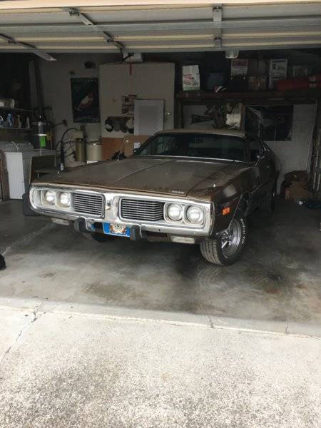

So I've had this idea bouncing around in my head and I'm curious how realistic it is. I got a 73 Charger and I love it. One thing that always bothered me is that it has 4 headlights, but the inner are only high beam. I fee it'd look better if all 4 lit up low beam and high
My thinking is, I should swap some modern challenger headlights. Even better, with the Hellcat versions, I can have "ram air" from the inner lights.
Basically I just want all 4 lights to work for low ad high beam, plus newer headlights have better lighting so I can see more.
Is this even a possibility? Would the wiring for it be absolutely insane? What am I trying to get myself into??
Thanks!
