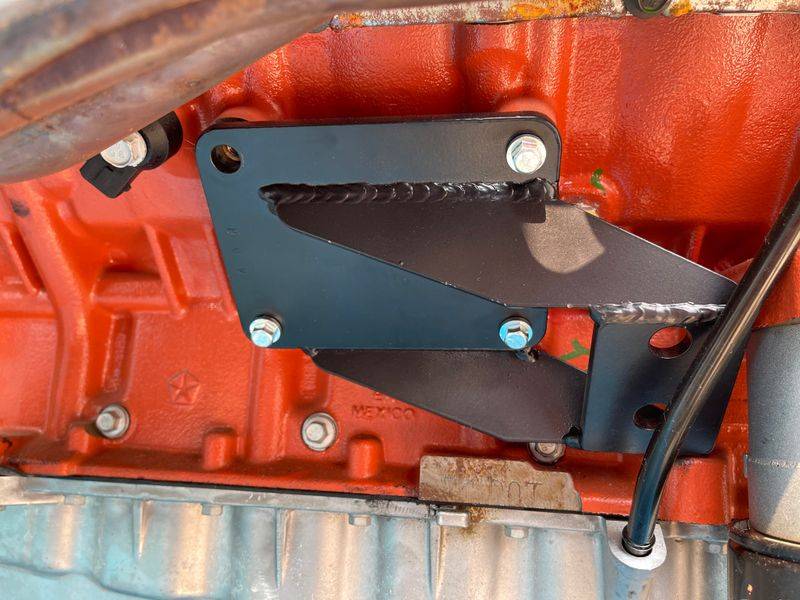

I started the process of installing my crate motor into the 71. Although i have looked around the internet i have not been able to find clear step by step instructions on how to do this (maybe i'm looking in all the wrong places). So I decided to just start on it and here is what i have discovered so far.
Motor mounts from TTI seem to fit perfect, they come with the 7 bolts needed for installation.
The drivers side goes on with no issue as does the passenger side however, the dipstick is in the way of the passenger side mount. The dipstick must be removed and another one purchased that is fitted to the drivers side. This doesnt appear to be a problem since there is already a location on right side for the new one. I chose solid mounts for this car. As you can see in the pic the mounts are not even close to clearing the oil filter. Hence, the oil filter must be relocated. Instead of a 45 or 90 degree angle adaptor i went with a remote filter kit.
Of course, the oil pan will not work with a v-8 k frame. It is way too far forward and way to deep. A center sump Milodon pan will be taking its place. The existing oil pump pick up tube will obvisouly not work so i'll install a new one. To do this i need 4 new main cap bolts. Apparently the factory windage tray will still work, we shall see. I should have these parts all here next week.
So there it is, right at $1000 for parts and the damned thing isnt even off the engine stand.
Maybe it's the picture but that passenger side mount looks a bit wimpy.
The two pieces welded to the flat plate bolted to the block look about
1/8th to 3/16th thick. Seems like a pretty weak setup with solid mounts.
Dave
Your gonna be changing that pan anyway so the dipstick isn’t an issue. Also your k frame isn’t gonna work with that oil filter set up. Either notch it or get an aftermarket k frame. I think that filter set needs to stay on a Hellcat, don’t quote me in that.
There’s a good thread on e body I’ll see if I can find it
