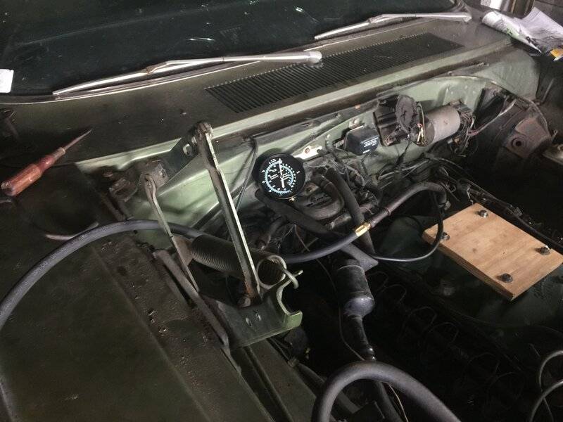

After I got the dodge back (a few months ago) I removed the carb, plugs, and it turnover by hand pretty, so did a compression; all were about 155-165 except #6(?) that would only get up to 135; when I bought the tester I told the dude at the counter what I was doing and why; he said:
“DON’T! No good will come from it...” In kind of a joking but truthful way... he was kinda right, but I’m okay with it.
I didn’t know back then they were pulling additives from the oil or how that hurts non-roller lifter engines; anybody think my cam lobes on 6 are flattened a bit, and that could that cause lower compression (30k on the engine with low phosphate addictive oil)?
Anyway I put in new plugs and the carb back on (was disconnected to fuel and the fuel line plugged), poured some fresh gas down the carb and it fired up! Although expectedly pretty rough with no fuel in the carb...

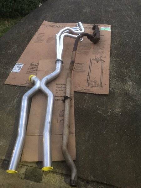

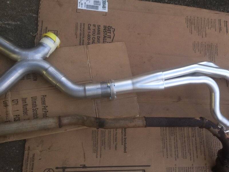

Gunna pull the intake anyway to install the valley-tray with the exhaust passthroughs blocked off; still on the 2 barrel exhaust manifolds (yeah v silly; I know) wanna get tti 1 7/8” w/ 2 1/2” x pipe... any thoughts on that?

I got TTI exhaust installed, rebuilt the carb, flushed the gas tank and fuel lines.

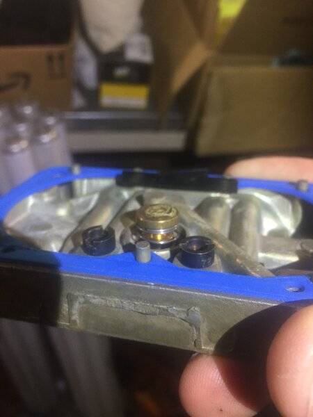

Used a dial indicator to map the intake valve travel on #1 and confirmed the cam timing was right. Centerline is at ~107.
Have an off idle pop out the carb I never could fix. Everyone person told me it was a vacuum leak or maybe I installed the timing gear/s wrong. Nope.
Pretty sure it’s carb tune; read stuff on low vacuum engines (I’m at 10”), you can easily set the idle speed screw is to high and you’ll get into the other circuits, and then you will set the idle mixture screws too lean. Gotta check if they are open too much, and the drill the butterflies or something to get off the wrong circuit at idle.

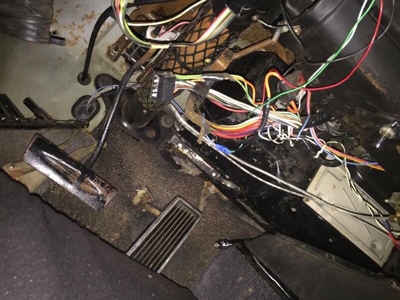

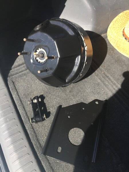

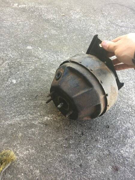

Just pulled the booster and had it rebuilt and got a reproduction disc master cylinder to replace the drum one that was on there (has the original 4 pistons calipers; they were rebuilt in ‘96, stainless sleeves & pucks. Will see how they held up).
Think the proportioning valve is probably bad also; rears use to always lock up easy, but will see with this master cylinder on there.
Gotta vac out some old mouse nests i found in the cowl, clean the ducts, and find the heater core leak (disconnected it back then), and get the vacuum operated stuff working.
Wonder if it just from not having enough vacuum for them to operate, never installed a vacuum reservoir/
tank; will now, again have 10” at idle
Am doing that heatercore & a/c stuff now since I had to take so much under the dash apart to get to that one damn booster nut...
