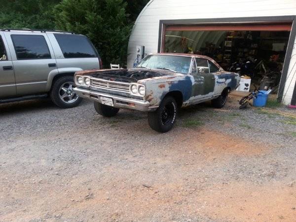

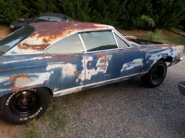

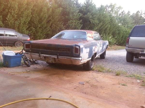

Welcome to the best Mopar gang on Earth! Pics before the hanging ropes come out...
