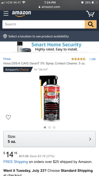

Check out a chemical tuner cleaner and lube called De-Oxit its what I use for electronic restoration of pots and tuning Caps and tuners. It cleans and lubes and doesn’t degrade plastics or phenolics. This is the only stuff I use now.
The tune knob changes the dail. Push on any of the buttons and dial doesn't move.
Thanks for the tip on the De-Oxit
