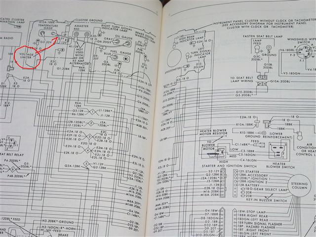

Here is a pic of the 72 Rallye gauge wiring diagram. The only wire not labeled is the y connector from the voltage limiter to both the temp gauge and oil gauge. Could this be it?
