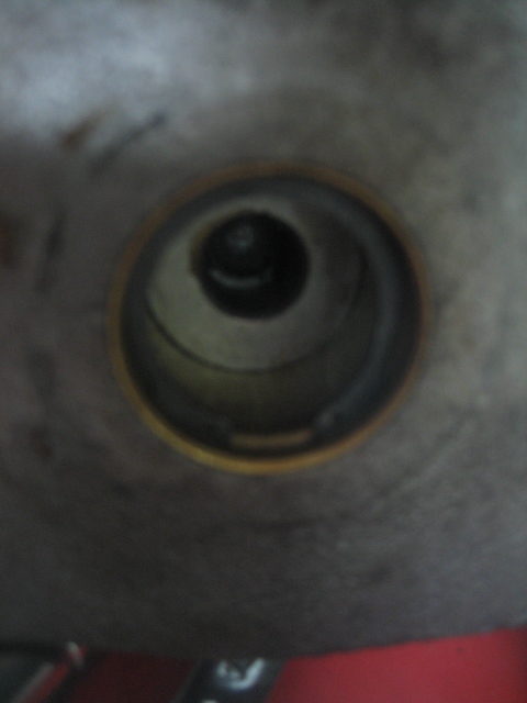

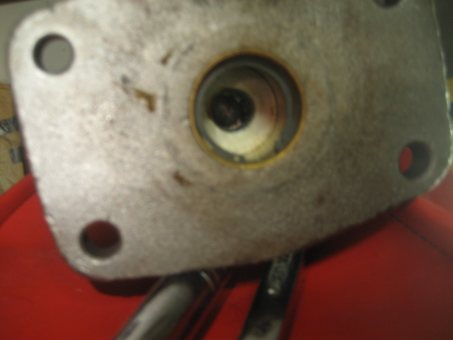

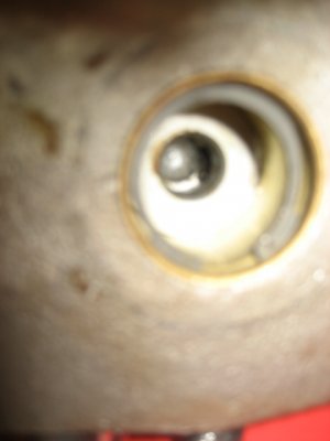

Got it off same issue as before So much for wanting to drive it next week
From your recent photos, the MC piston is hung up again. The way those things work, of course your not getting fluid through the rear pot, since the pistons need full travel.
You'll hate reading this, but...if you want it done right, do it yourself!! There's something wrong inside the master, dirt, wrong part, or just rough assembly.
Suggest you get a parts diagram for THAT particular MC. Then, bust the MC down. Simple...pull the snap ring...and carefully use low air pressure, at each port to blow the pistons and other parts out. Look at each part carefully, make sure everything is clean, and using the diagram, re-assemble it. If some part does not seem to fit right, take a harder look why.
The bore in the master needs to be fairly good shape, too. When it's right, the rear piston should be sitting against the snap ring...and each time pistons are moved in the bore, it should return against the ring.

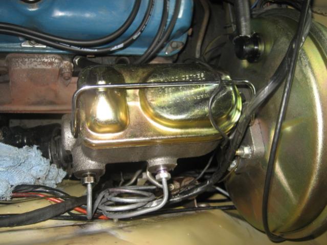

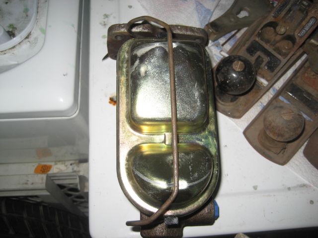

Put the Master Cylinder I got from Mancini Racing on. Got fluid to the front brakes now. Yea. Finish bleeding tomorrow. The Master Cyl on the car is from Mancini. One on Dryer is the one I've been having problems with.

I sent the Master Cyl out the first time to get rebuilt. Whe I got it back ad put it o the car the rear piston got stuck in the bore. So I sent it back. When I got it back followed the Service manual on bench bleeding like the last time and put it on car and as soon as you step on brak e pedal piston for front disc brakes got stuck again. So I said ef it and got Mancini Racing cast iron one. When I get a chance I will take the other one apart. You can do it yourself they make kits to do it. Try contacting Karps Brake Service. I sent my Calipers, Booster, Brake valve and Master Cyl to someone else and couldn't get the Master cyl to work right. All other items came out ok.
