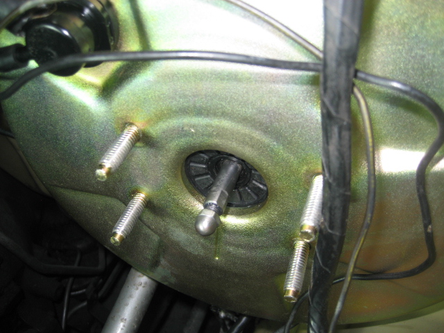

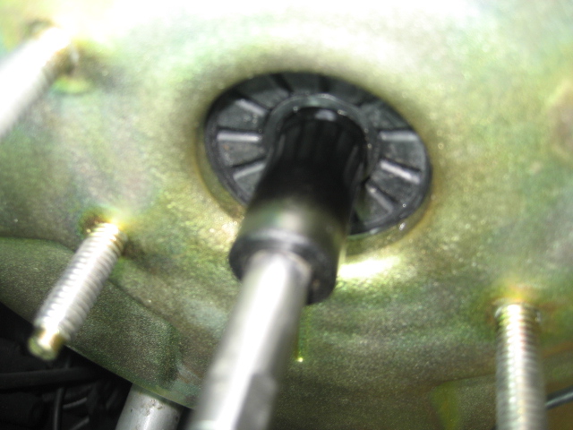

I got the Master cyl back off. On the Power Booster shaft there is a black sleeve that was inside the Master Cyl before I bolted it on car. It Is now stuck on the shaft even though I lubed it.
The black sleeve should not be used as that is used with a manual brake car so when you let go of the pedal, the rod doesn't pop out. Yours is a power brake setup, so the rod just pushes into the back of the master cylinder. The rod on the other side will have the same (or close to it) sleeve for the same purpose, Keeps the rod from pulling out. The master cylinder pushes the rod back into the power brake booster, so it does not need a retaining sleeve.

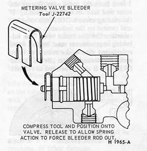

You could also have a valve shift in the proportioning valve. Not knowing your exact setup check the valve for a pin at the end and then insert this tool pictured or have a helper pull the pin out while bleeding in order to center the valve and allow fluid to flow to the front.Brake Bleeding Tool_J22742.jpg

No fluid from rear port I emailed the Ram Man. Just waiting on a response. Maybe I messed something up and didn't realise it. That plastic piece is not stuck on the shaft It's inside the booster fingers.
JMHO, but that sleeve may prevent the rear piston from uncovering the intake port, so you won't get any fluid when the pedal is depressed.

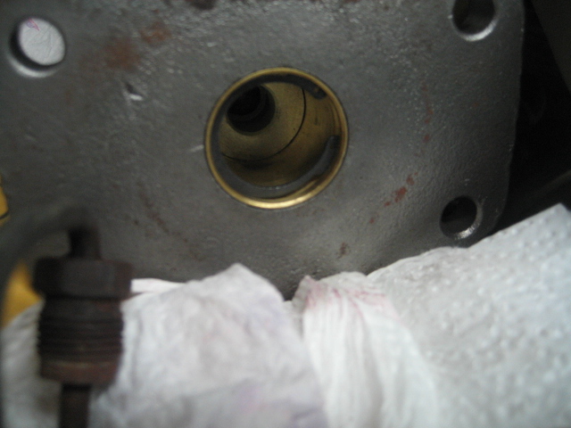

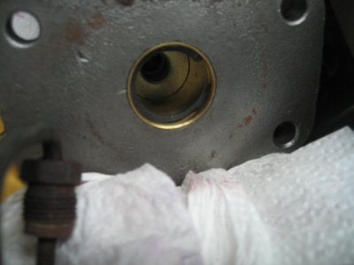

In your last pic of the rear of the master cylinder, the piston looks too far inside. It should be back against the retaining clip. Maybe it's jammed too far forward? Did it return to the retaining clip when you bench bled?
No it's still part way in the bore like in picture. It will go foreward I just looked at pictures of Master Cyl before I got it rebuilt and the piston is against the snap ring. So you are right the piston is stuck. How do I get that plastic sleeve off the booster rod. It looks like it's behind the fingers of the booster. I tried to pull it off when my son pushed the brake pedal down it just won't move So the black sleeve was in the Master Cyl when I put it on the car that would have made the piston in master cyl further in than against the snapring. I need a Beer.
Got ahold of the Ram Man. Sending the Master Cyl back. I also sent pictures of the Booster with the piston retracted and extended showing the plastic sleeve. He said it was ok. I got more stuff to do on it anyways. Next week I will get new Torsion bars. Jegs has them on sale. Just hope the fit my 72 Coronet. I'm looking at the .96 Bars
