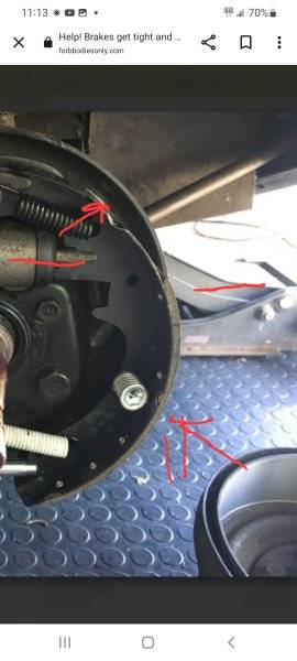

Yep. I actually talked to a person at Rock auto and they say I am the first to complain about these Bosch shoes. Their online picture looks exactly like my shoes.View attachment 1319522
You can see how the leverage point (top of lining) is lower than the wheel cyl arm.
It is self energizing hard on that point
