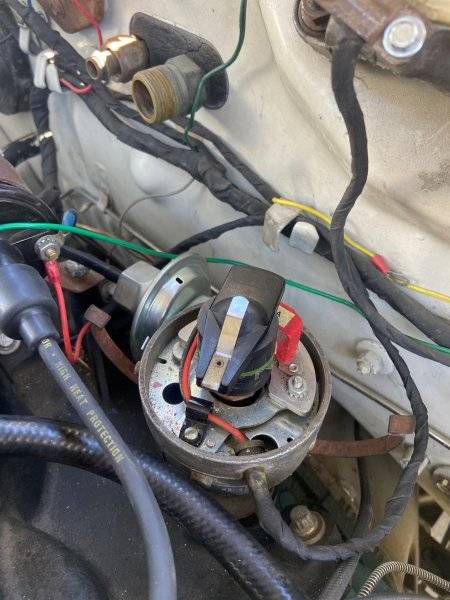

After still not getting spark from the cap to wires as I mentioned yesterday, I began to look at the Pertronix system. The black piece that sits under the rotor has a missing magnet that fell out, I'm guessing through centrifugal force. No sign of it rubbing against anything. If I can find it I will try to glue it back into place and hopefully that fixes the issue.
I spoke to Pertronix this morning and they said a magnet falling out would definitely have this effect.
