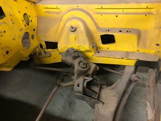

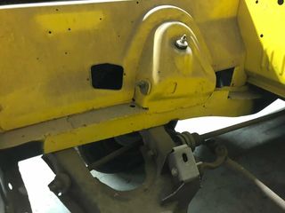

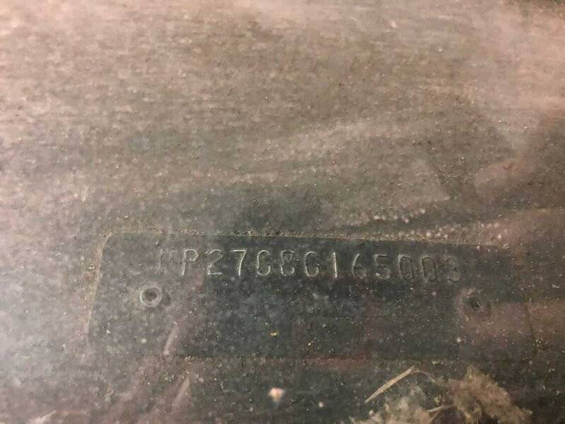

I'm looking at a Coronet roller in another State. The seller is reputable but the pictures are a little sketchy. There is no fender tag so I'm trying to read the VIN tag. There are pictures of the VIN and K member. I'm trying to figure out the original engine and to see if the VIN is a "C" or "G" and if the K member is for a big block.

Well it's not a 6 cylinder K & it's not a Hemi K so any normal V8 should bolt to it... Originally a 318, it won't have a skid plate but who cares? easy to add one...

I thought the code for 318 was F. A G would make it a 383 - 2b. That answers my question.
What year? I'm pre-programmed to 70 where G=318 but in 69 G=383
It looks like a "C". But, looking at it again, it's a "G" However, the first two letters are WP; so that would be a Coronet 500. If it'a a "G", then what came in the car was a 383 2bbl. What rear axle is under it?
A slant six Coronet 500 convertible would sure be an oddball.
A 383-2 is WAY more likely.

looks like a 4 speed car
I'm curious what gave that away. It has a 4-speed transmission hump bugger welded in. I was trying to figure out if that was part of a repair. The rest of the floors look original.
The bracket welded to the L frame rail for the clutch bell crank..
And the 27 means convertible in case you weren't aware..
The clutch pivot bracket is visible on the drivers frame rail. So either its a manual trans car or was converted over the years. Pretty rare if an original 500 4-speed vert.
Could have been a factory 3 speed manual trans as well?
