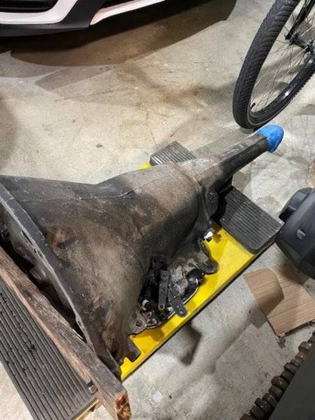

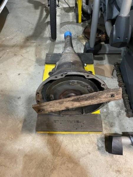

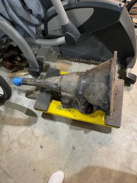

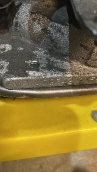

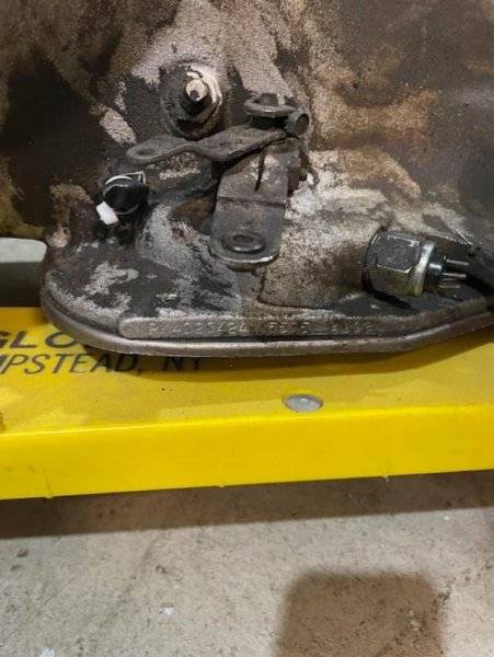

Can anyone verify what year car this 727 transmission is out of ? Thank You
I cant quite make the four digits after the trans id number... if it says 5575, then it was built November 1, 1976, so for 1977 model year vehicle.
I want to sell this transmission so I wanted to verify what it is first, thanks everyone.....
