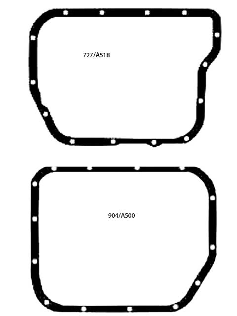

How do I tell the difference between a 727 and a 904? is there an easy way or is it just looking at the splines?

The pan would be a easy way to tell.
Awesome, thanks everyone.
