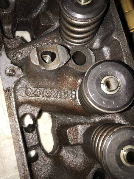

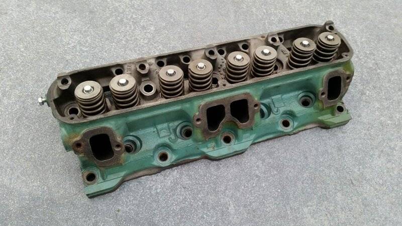

https://www.mopar1.us/headcastnumber.html
Here's a chart and a couple photos to help. Some also have a letter designation between the exhaust ports. You can see that from the outside. (between the spark plugs.) The green ones happen to be J heads. The letters are general casting designations only.
