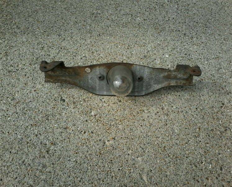

It's above the license plate. There is 2 Philips head screws you need to remove. Me personally I would unscrew it with the 2 bolts on the outer edge and unplug the wire and do it out of the vehicle as it is probably rusted, you will end up stripping the Philips head screws... so 2 bolts and unplugging the wire makes it easy to work on out of the car. Looks like this..
Agree with above, remove it and work with it outside. I had rusted screws and one broke off... finally got it out yesterday... spray the heck out of it.
There is not other way that work it outside LOL. Bracket needs to be removed to get access to the license plate light lense and socket anyway.
