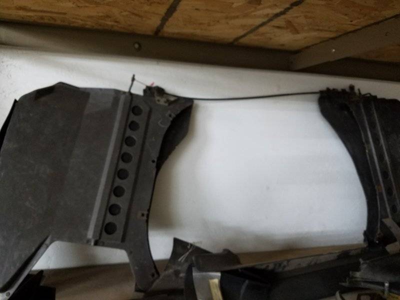

Yeah, that is one of my questions. I have never had a car with this style hood before. The car was taken apart when I bought it and I am not certain what all needs to be utilized if I just run s standard air cleaner.

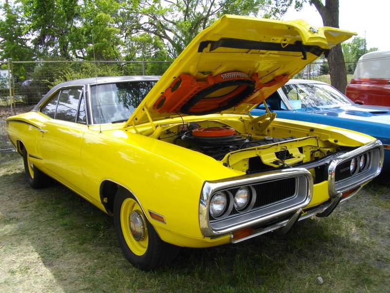

Yea I am saying run it without the orange duct work shown in the pic below. That way you can get the scoop look outside without dealing with the connection point underhood and basically run whatever intake you want providing it fits under the hood like any other car at that point. The scoops would still funnel fresh air under the hood, just not directly to the intake. Original no, but looks factor outside the car would be alot cooler than the bulge hood in my opinion, and if its a modified engine then originality goes out the window anyway. If you are building an engine that needs more power then an aftermarket low rise intake will give you that fits the stock airbox, then its past originality anyway in my opinion. Just some **** to think about.

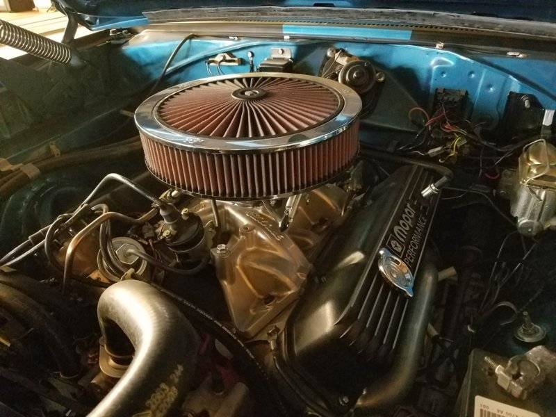

I run the Performer RPM on my 383 with the bulge hood. The only reason I use a drop base is because I'm using the Edelbrock heat insulating carb gasket. I'm running a reproduction unsilnced air cleaner with the drop base from Mancini.

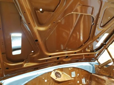

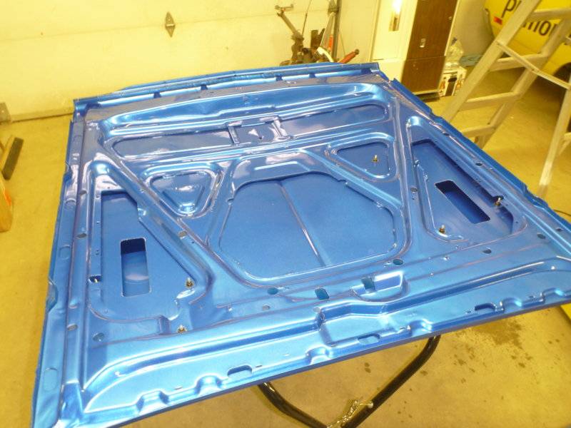

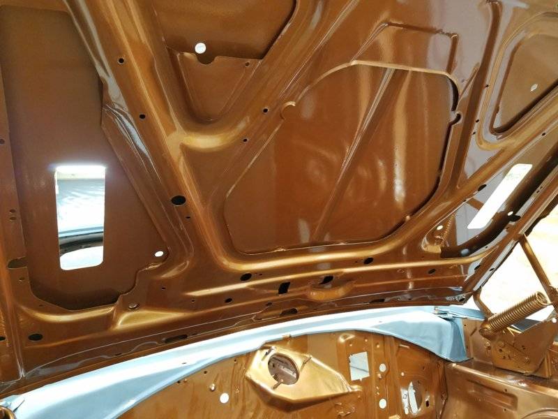

So this is what I trying to understand. Wouldn't I have to rivet these 2 pieces to the underside of the hood in order to kind of finish off the 2 holes in the hood? And if so, I should still be able to get an air cleaner like this to fit up in between them?

What your choosing to use I dont think the duct work can be used......

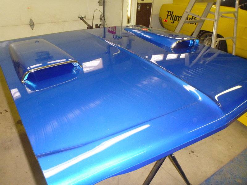

Put the ram charger hood in the corner with the original engine. Put a fiberglass six pack hood on the car.
Yea once you put the scoops on the light won't show through the hood and you wont barely notice the squares in the underside like you do now. Let the engine get cool air from the scoops and run it! Other than the two square air holes, most of those other holes are in all hoods anyway for the underhood insulation so it won't look much different. I prefer a steel hood with the hinges and latch over a fiberglass hood but that is me. I don't trust the fiberglass hoods without hood pins and I wouldn't wanna drill for the front pins in the core area.

You have about 3/4”-1” of HOOD clearance with a 383 and a 383 airgrabber air cleaner. Going to a 440 airgrabber air cleaner will buy you another 3/4” HOOD clearance. That’s the first part I’d be worried about.
Then if you leave the seal off the center portion of the duct work you may be able to buy another 3/4”
Total stack height first then the airgrabber.
