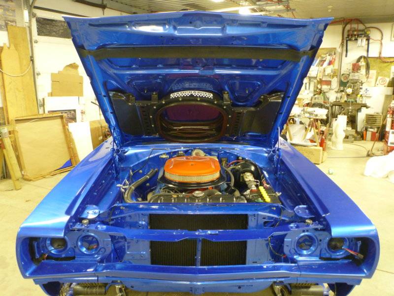

So you are making it sound like a guy can install only the 2 side pieces of the ductwork on the hood and nothing else? Then run a standard air cleaner like I showed on my blue Road Runner in the pic above?

View attachment 768303 View attachment 768305
Looks badass dadsbee!! I actually think it looks cleaner that way then with all the airbox crap under there. I mean I get it for a resto that's stock, but it doesn't look bad at all the way that blue hood is now.
No, it looks better with the air box under there! Was just showing it can also look very clean without it... :thumbsup:

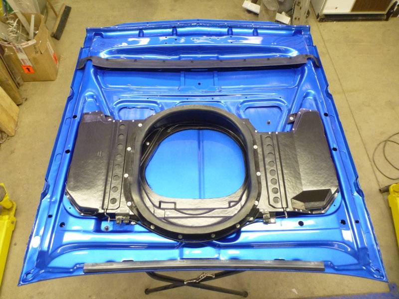

Just remember, the center ring has to go in first if you're using it all, so if you only mount the sides and then change your mind you're taking them back off (or at least one side may give you slip in room) to put the center on.

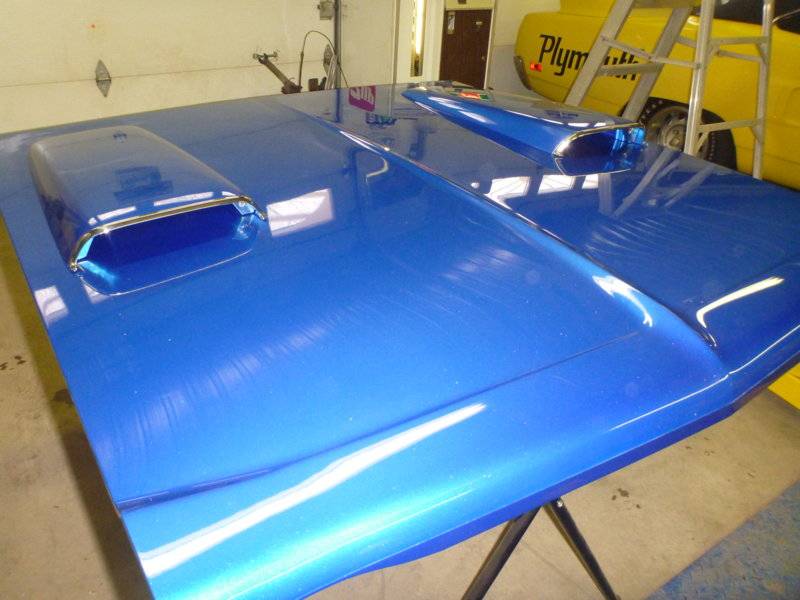

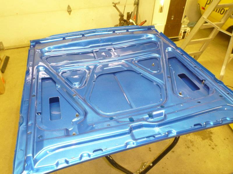

View attachment 768341 View attachment 768343
Yea I knew you had it all assembled I watched your build come along. To each his own, I prefer the factory hood showing without the plastic stuff. Some of that stuff to me just looks like too much from time to time. Plain jane for me is my linking. Either way they look great as does yours!
I would not install just the sides, that would not function well or look good. All or nothing, I think it will look good either way.
