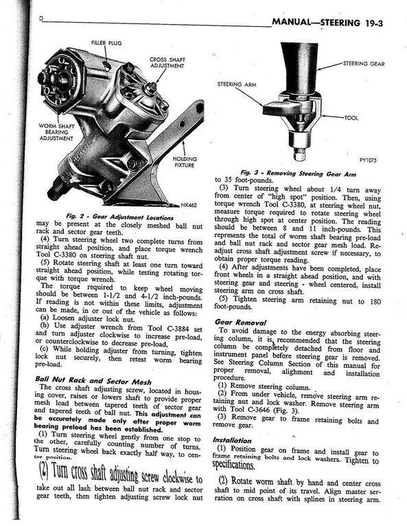

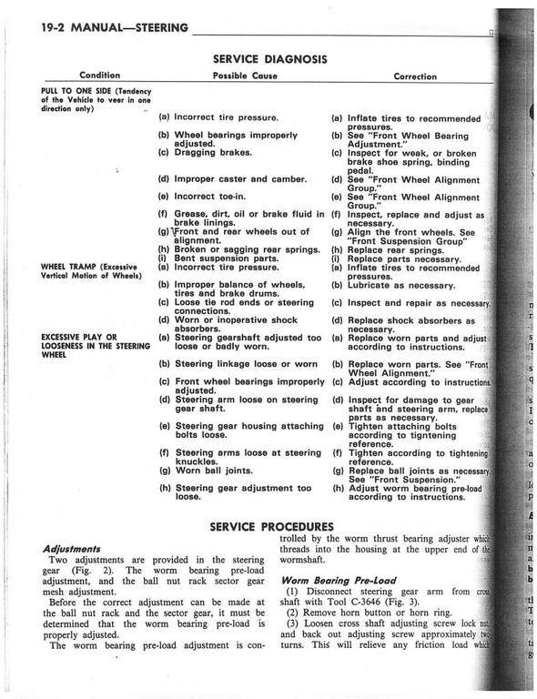

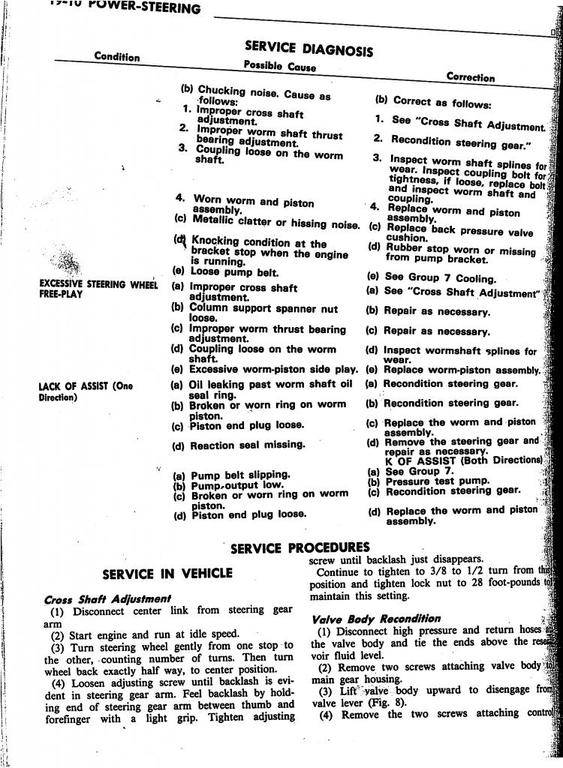

Here is the one for power steering:

Yep, try adjusting the box like the service manual shows. If that doesn't help you might need a new gear. I agree with Dennis about Firm Feel, they do good work.

Just wanted to update this, I ended up adjusting the sector shaft, it was just barley looser that it should have been so that didn't help.
