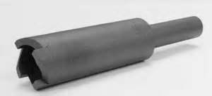

This is called a swedge cutter for wheel studs some brake shops should have one to do the job call around your area.
