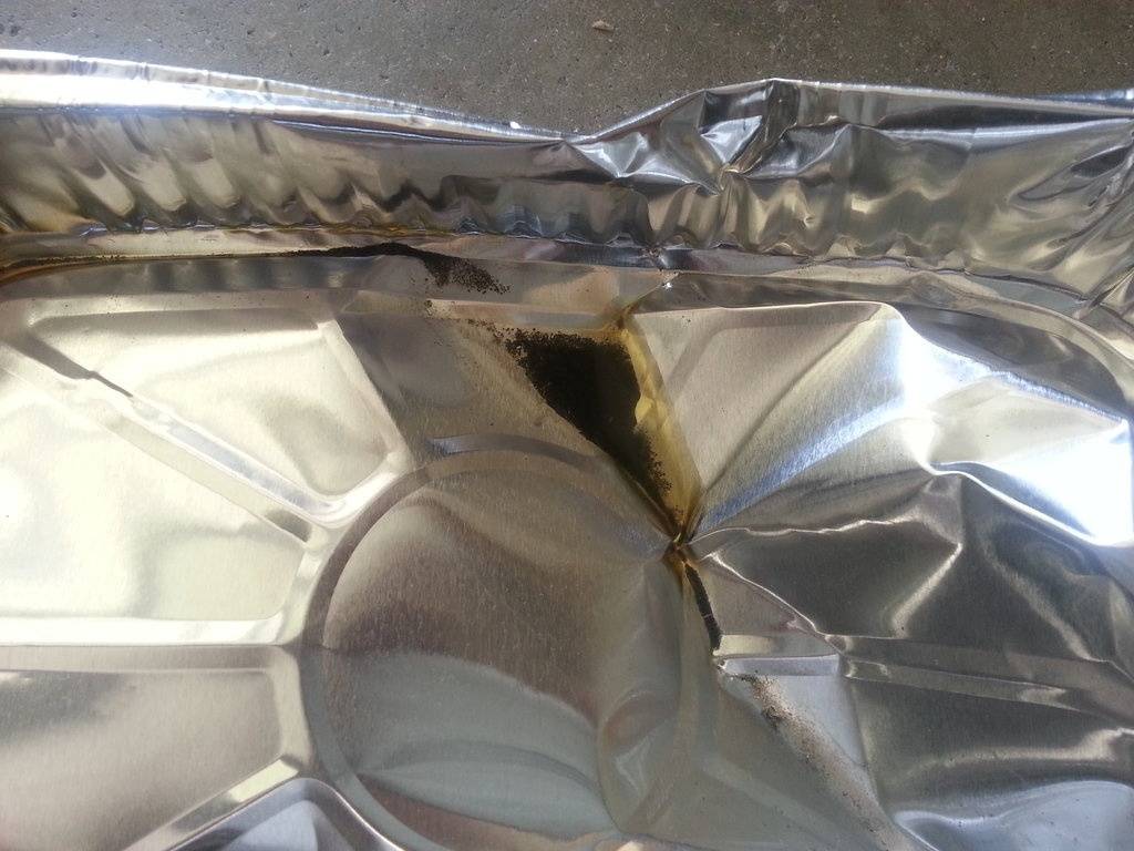

I went ahead and took the fuel filter out. The tin pan I caught the gas in had about half a teaspoon of rusty sand (picture attached). Quick trip to O'Rielly for a new fuel filter, seafoam, and some Stabil 360.

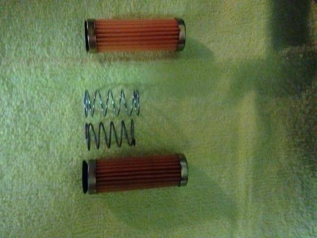

In the meantime, I have been googling around on quadrajets. I see that the fuel filter should have a spring to seal the rubber gasket to the line. I did not find a spring. So, do some quadrajets not have this spring, or is it missing?

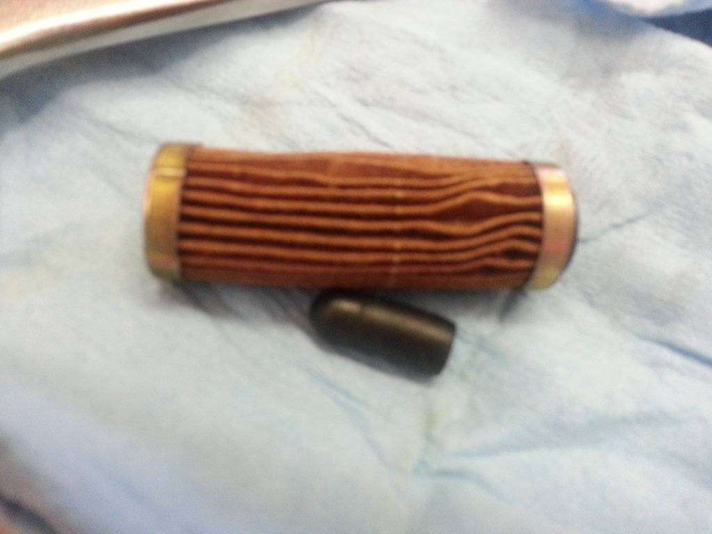

It is a paper element filter that fits in the bowl; see picture of old filter.
drain the tank, take it out rince it out.. blow out the fuel line.. imagine that going through to the rings..
For fuel leakdown, well plugs are known to leak on the Quadrajets because they come loose, and a common fix is to use epoxy to seal them up. As far as the filter goes, when I rebuilt mine for my 87 Dodge PU, I put a new filter with the rubber end in against the advice of my friend who has rebuilt quite a few carbs. I started to have starting and stalling issues, but when I removed the filter, it started right up, and ran fine. There is an inline filter before the fuel pump of course.
Yup needs a spring. With that much trash you can bet the sock in the tank is plugged up also. As stated the well plugs a leaking also. I worked for GM as a tech for 25 plus years and rebuilt hundreds of Q-jets. Hopefully its not one of the feedback C-3 carbs as parts are hard to find, I still have all the Mickey Mouse tools to adjust them though. The non C-3 carbs are a good unit with the exception of the primary throttle shafts wearing out the base plate bores but can be re-bushed. Good luck and if you need advice on rebuilding it let me know. P.S dont buy a rebuilt one from the parts houses= junk.
Be sure the carb did not get clogged with charcoal debris from the evaporator canister.
I had a Trans Am that did something similar. Take a close look. I think you're "rusty sand" might be the carbon out of the charcoal canister. They have replacement filters for the charcoal canister that look like a little white pancake about 4" diameter if I remember correctly. I rebuilt my Q-Jet 3 times before I figured it out. The carb kept sucking the charcoal into it.

Well, there was a spring in the filter, but it is compressed somewhat (see pictures of new and old spring and filter).
