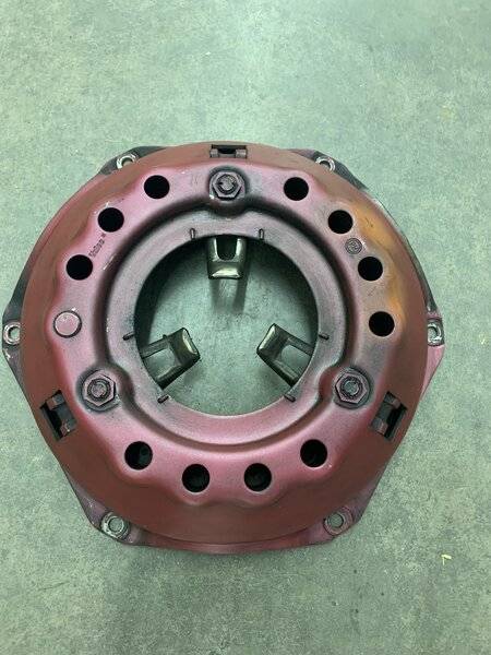

Well, sitting over here on the other side of town, I have clutch stories to tell...as you know.I was happy with this pressure plate and pedal effort but not sure which one it is other than a RAMView attachment 1108124

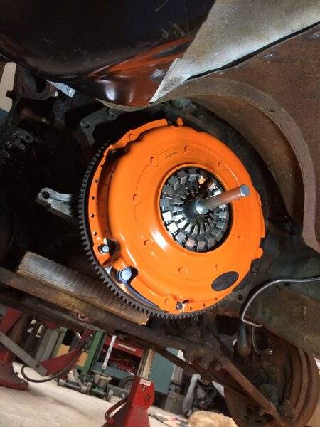

Suffice to say the current setup in Fred is a RAM 18 spline B&B package from Brewer's - this, after
all my travails with a Centerforce Dual Friction setup (which worked fine; wound up, I just couldn't deal with
the pedal position).
The RAM has proven to be a good, beat on it sort of clutch (it's their "performance" one) that's probably
considered stiff to many these days - but it reminds me of the factory clutch, so I'm fine with it.
I'd be happy with the setup - if only the monkey I hired to install it and the transmission had bothered
to resurface my factory 11" flywheel when he did so....idjit.
Chatter on takeoff will ensue now if not carefully executed and I need to borrow a lift one day to correct
things - which would be nothing more than pulling it all apart to get the flywheel resurfaced.
