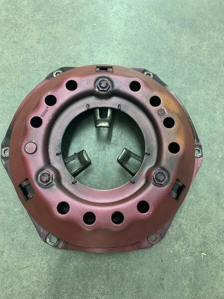

I was happy with this pressure plate and pedal effort but not sure which one it is other than a RAM
