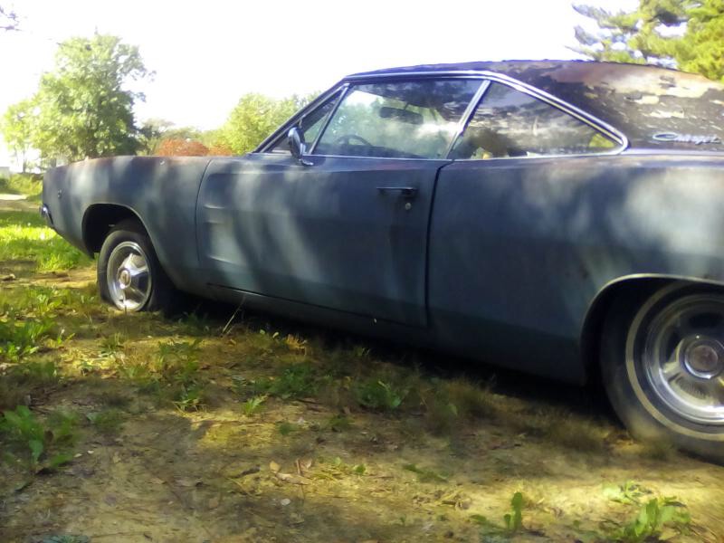

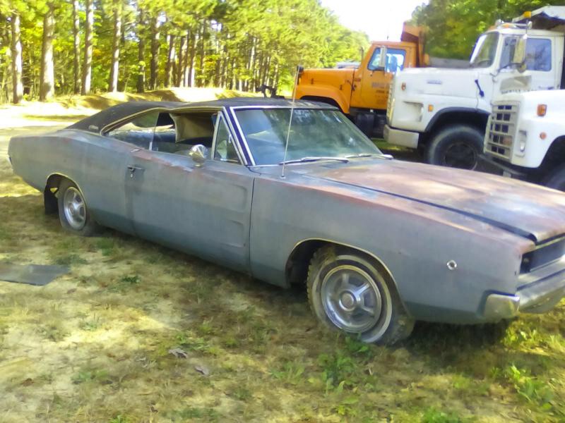

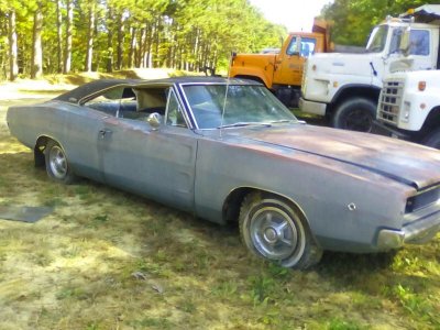

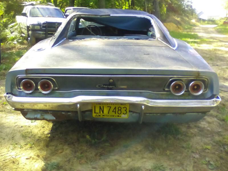

Threads are worthless without pics so here are a few of my car.

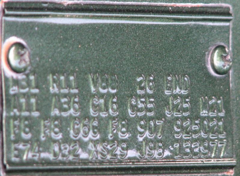

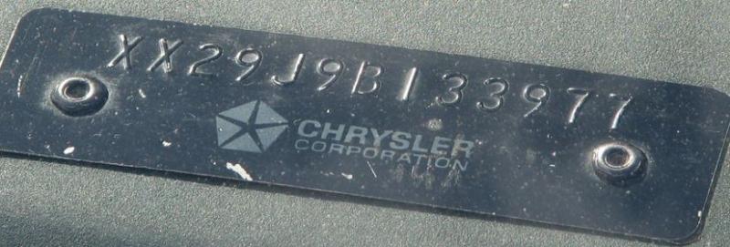

As I was reading the forum: I came up with one more question. I am more familiar with the mid 70's fender tag so my 68 tag is new to me. I decoded it and everything matches the car but I didn't see a partial vin or anything. How can I confirm this is the tag for this car and know it hasn't been swapped?
just match the vin tag to the fender tag
Like this one (borrowed from the internet - I wish this were my hemi 500)
Beyond this there will be another on the radiator core support and the trunk gasket lip.
Obviously the motor would have the 6 digit vin # stamped on it along with the transmission if it were all matching,
Hope this helps.
This is a great car and totally worthy of being saved. One thing I will say is you better have deep pockets. Stripping the paint will reveal a lot more rust issues that you can see at the moment. You have a lot of sheet metal to replace. My advice is to strip the car and fix the body first. Why tear down the engine and rebuild it when you have nothing to put it in? You are better off concentrating on getting the body rust free. Good luck with it which ever choice you make.
If the car is in the garage, why not get some of those Harbor freight casters to put under the tires. From what you've said, and looking at the pictures, you better be dedicated to the work and money and time this car is going to take.
Hope this helps.
