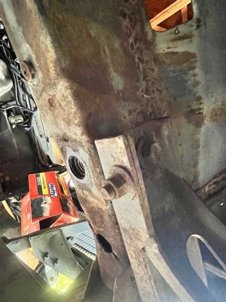

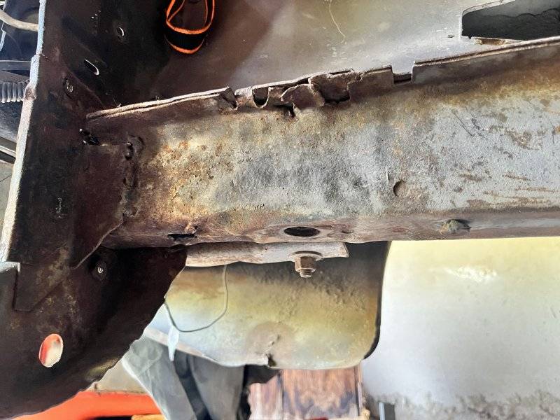

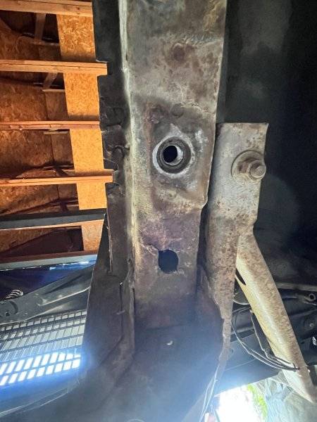

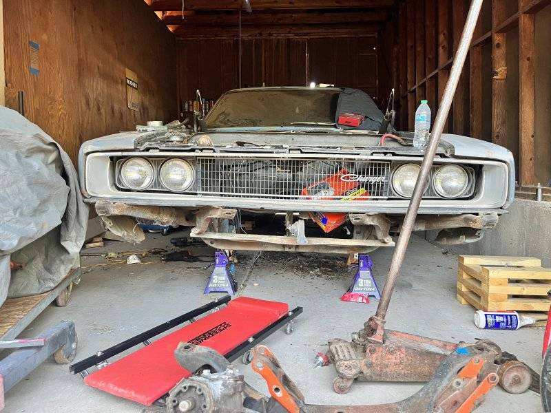

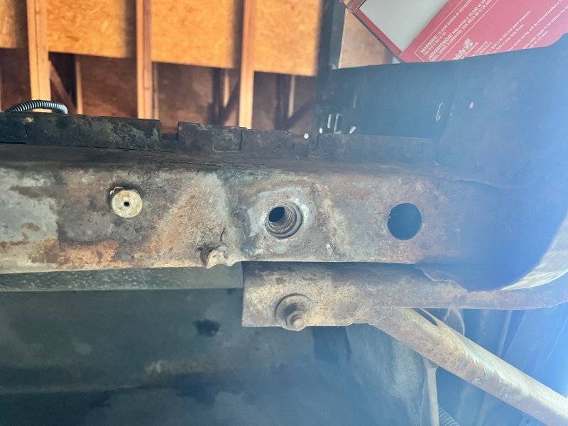

Good evening all,
I've pulled the engine/trans/front suspension out through the bottom to gain access to the front frame rails. It's been in an accident at some point in its life, and it looks like the part of the front clip has been crudely replaced and the frame pulled. Just past the first K-member bolt on both sides, the frame rails are still bent despite someone's attempt at straightening them in the past. The car still has a pretty good tilt toward the driver's side, as you can see in one of the images. I'm imagining something else wasn't welded in properly to make it so cattywompus. Has anyone replaced just the front section of the frame rails? I'm not sure how to remedy this.

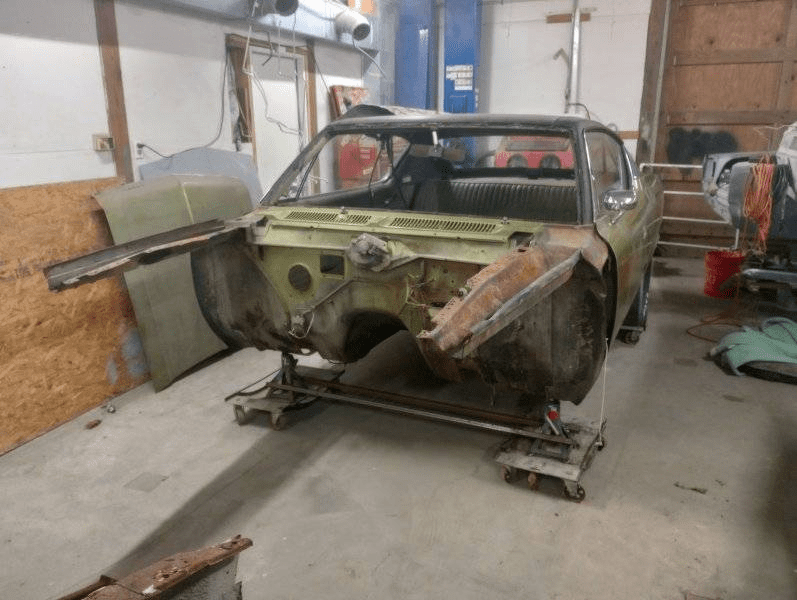

Thanks to the coach, I was encouraged to pull the entire front stub off and just replace it.
I did just that.
My first time ever and it worked out so well, the car drove straight and true without even having a professional alignment. My panel gaps are great.
What you need though is a front section from a 1966-70 B body.
I did just that.

I used tape measures, levels and paint stir sticks in between the panels to get the gaps right.
I did just that.
Now, do I have the gusto to replace a front stub... I may be forum illiterate, but is there a post you have on the project? I can't find it. Maybe it's not as bad as I'm conjuring it up in my head
