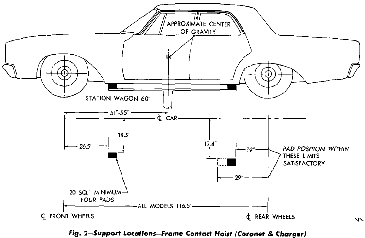

The other side has a metal plate my brother welded in to support it years ago. So it was patched, but no telling how well.What does the other side look like?
Is there an engine in the car?
I had a 66 Coronet 4 door parts car with frame rust in the same area.
Inside and bottom were gone.
Top and outside were still there.
I drove that car.
...and it drove good. No steering issues or odd noises.
The engine is still in and we've considered removing.i was hoping to wait until I'm here to remove it so nothing gets lost and I can tag & bag everything.
