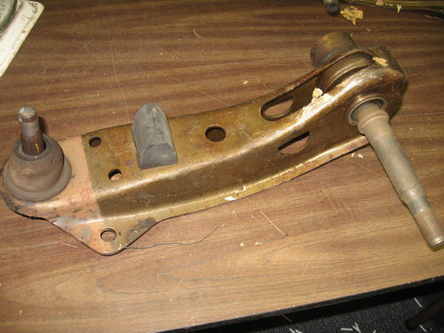

help please , need to find 1973 rr lower control arm bumpers . i cant find them anywhere . does anyone know who sells them ?
thanks RANDY
yes but no the 73 bumpers are more rounded . thanks
Here a pic of an NOS 74 C-body lower control arm. The rebound bumper is the same as 73-74 B-bodies though.
Nobody makes the "original" rounded style. got a set of prothane ones, 1B04-19-1303-BL, they are not the rounded type, and I have actually seen NOS bump stops that are the same style as the new urethane ones like from prothane. It is possible that this part was superseded by the other style that you commonly see. I was able to recondition a set like what you are looking for and will most likely put those on my car and take the urethane ones off.
If your originals are not cracked, and still securely attached to the metal backing plated, soak them in a de-rusting solution to get all the rust off the bolt and backing plate, dry and repaint the backing plate, then use some '000' steel wool and dawn to clean the rubber, then spray them with a conditioner like aerospace 303 and they will look as good as new!
