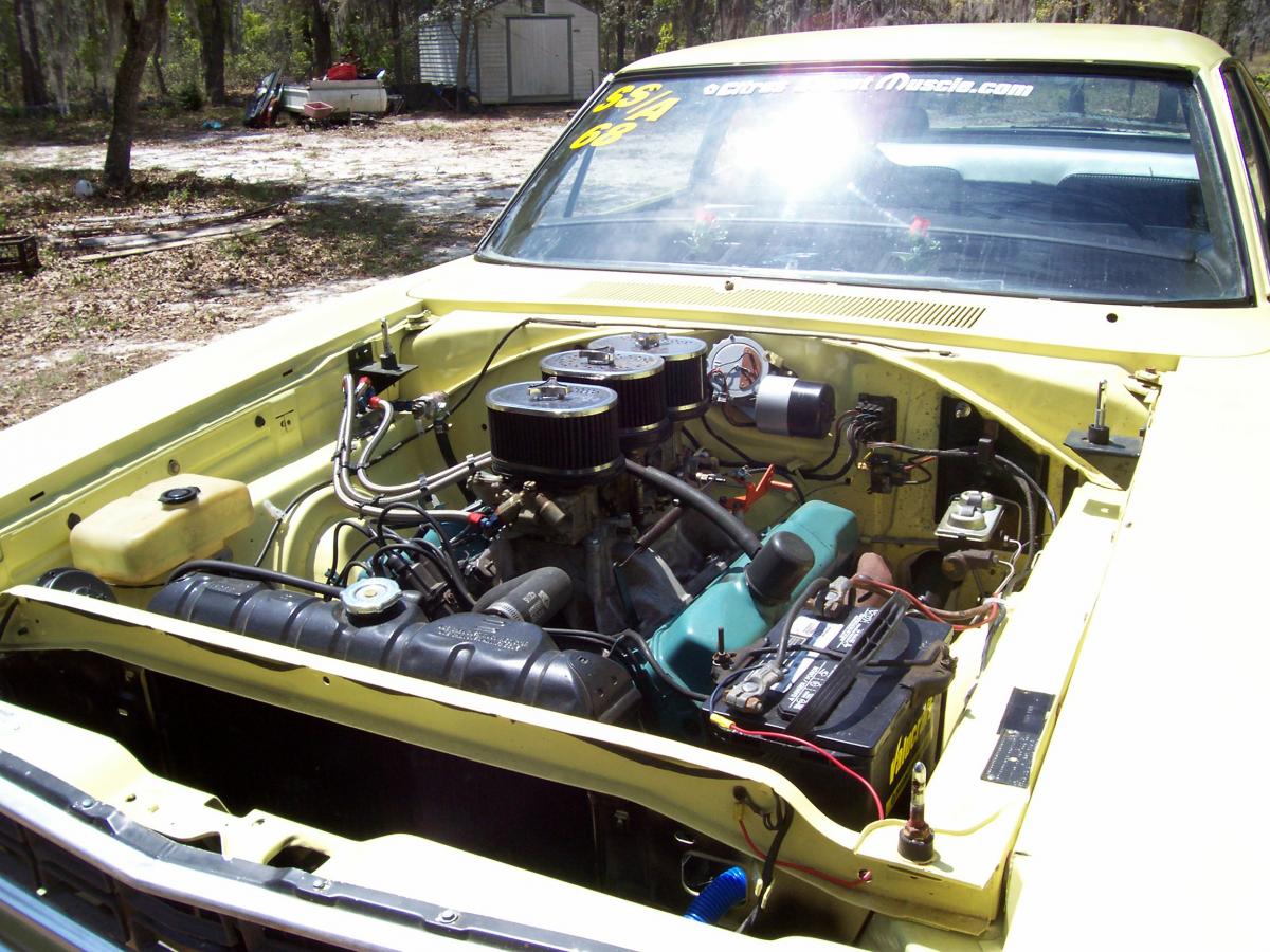

Hoping this might help,My 440 which was supposed to be from a 74 police pusuit car,was stamped 4 T 440 HP2 on the pad.It had the windage tray,2951908 rods,and I believe 316 casting heads. . . . . . .I tossed the cam for the 292 509 purple shaft,swapped in LY rods and stock pistons,and some mildly ported 452's. good mid 12 combo for the street
